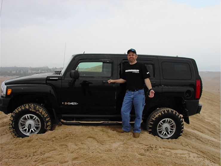

I went last year to Silver Lake with my H3 and had a blast. 4 high lock and 12-15 lbs in the tires is good. I made it up all the hills but it took me a few times to get up and over Test Hill- I got stuck right on top because I let out of the gas too soon (see the picture).
A few tips- put some plastic sheeting on your floors for easy cleanup and if you have a sunroof make sure is closed or you will get covered with sand.
Have Fun!

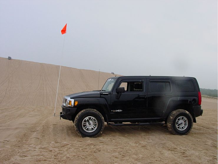

Test hill in the background- it's a lot steeper than it looks.

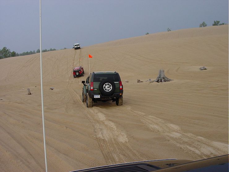

One more of our group- its a HUMMER Happening sponsored by Capitol HUMMER in Lansing. We had about 20 all together.
