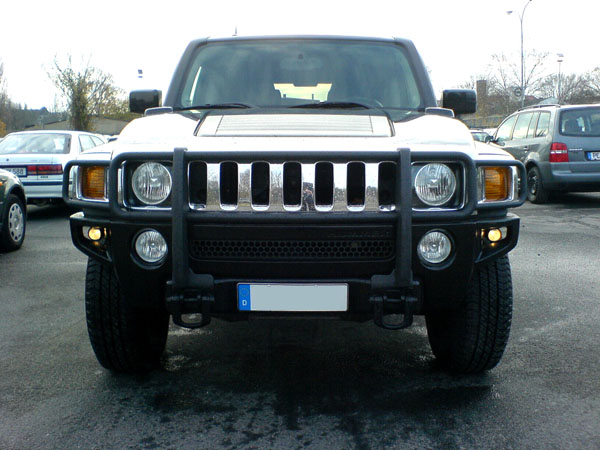

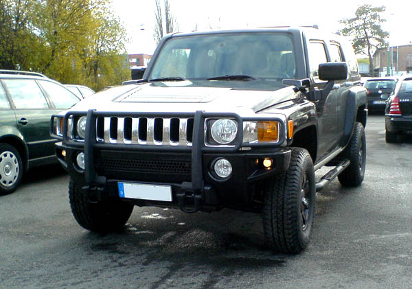

This is a pic of my H3 with my custom eurostyle parking lights. In Europe it is not allowed to have yellow parking lights, thus I had to come up with a custom solution, which to my surprise changed the front appearance of my H3 quite drastically. I think it looks a little wider with these lights... but maybe that's just me...

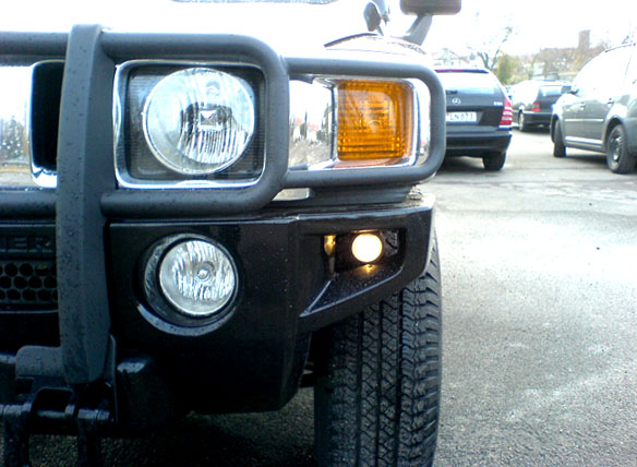

detail shot...

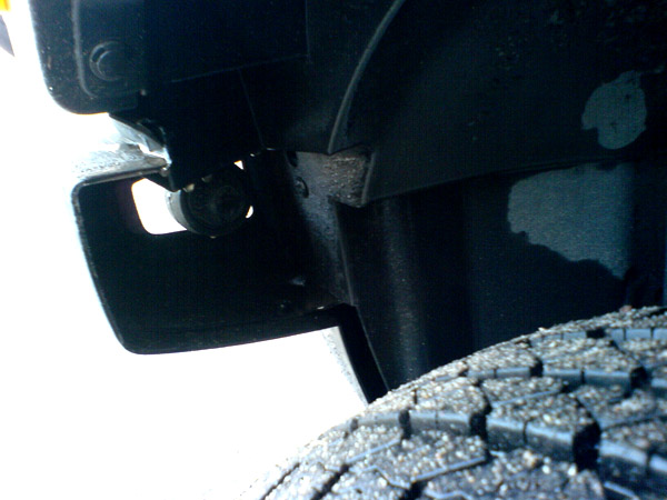

Another shot...

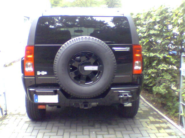

From the rear... cleanly integrated, no visible cables.

Interesting. That gap in the corners looks okay when it's empty, but with the light in it, it looks like it needs to be filled in. I be it'd look even better if you could find/fab a black metal plate to surround the lights and fill the gap.
Looks like nice clean wiring from what I can see.

@ree: The lights are exactly centered (left/right) in the hole. It acutally looks pretty good in person and you don't realize the gap, since it looks all just black around the lights. I kinda like the space around the lights... but that's personal preference, I guess.

I changed my US Vette taillights to European with clear with amber silverstar bulbs a few years ago. </div></BLOCKQUOTE>Actually the flashers MUST be yellow in all European countries. I had the white backup lights converted to flashers (with yellow bulbs) and an additional backup light has been mounted to the car (because it's okay in Europe to have just one backup light). I also needed to add a rear "fog light" (also a requirement in Europe). Here's a pic of the rear view. Note the lights underneath the bumper...

<BLOCKQUOTE class="ip-ubbcode-quote"><div class="ip-ubbcode-quote-title">quote:</div><div class="ip-ubbcode-quote-content">Originally posted by alberto:
How did you solve the problem of having the DRL light in orange? thank you for your help </div></BLOCKQUOTE>Well, the cable which was for the DRL in the turning lights now leads to the tiny position lamps I put into the small openings in the front bumper (see pictures above). The turning lights will still work, but the DRLs are now the tiny lamps in the bumper.
