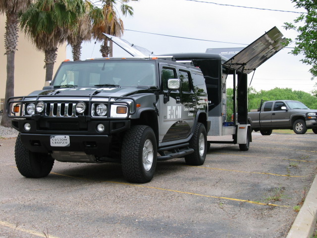

First time post, have a quick question.
I drive all across the country in a 04 H2. I pull a 4300 lb trailer for my company, driving from city to city showing off our products.
My company, EATON, is one of the largest suppliers of supercharges in the world.
Question is this: If we add a supercharger, will it help with pulling a trailer? Will it improve gas mileage, and will I still be able to run 87 pump gas.
I appreciate the help.
See attached pic of the Custom Cruiser. My job is to drive around all day in an H2, doesnt get much better than that!

EATON would know better then anyone here about their own superchargers and they affect any aprticular behicle. But, I can't imagine any supercharger is going to give you better gas mileage as a supercharger is meant to force more air and compress it into the fuel mixture in the engine for more power.
It will help with pulling the trailer, but mostly if your hauling up hills alot. You'll get faster take off with it and a trailer connected.
If your looking for better fuel mileage, add headers aas well as cold air induction and cat back exhaust. You'll get a bit more power too cuz the engine doesn't have to work quite as hard cuz it can breath easier.

To clarify for everyone, EATON makes many products, specifically this vehicle pulls around electrical products: Breakers, Loadcenters, transformers, etc. I work for the electrical division of EATON.
A little more about EATON: We make 90% of the Over Highway Truck transmissions, 75% of the axles, 90% of the golf grips in the world, and chances are if you fly commercial or military planes, the fluid power and hydraulics are made by EATON.
It was my idea to put an EATON Supercharger on the vehicle, to show customers all the different products we make.
I was just asking on this forum to see if anyone else has used a supercharger on an H2 for pulling a trailer. Pros and Cons. I know the supercharger is a good product, thats why we want to put one on it.
I was asking to make sure that the H2 platform will be able to make good use of the supercharger in this application.

my last 2 trucks, 01 lightning and 03 f150 harley both had ford factory eaton superchargers
and i towed my fathers street rod all over with those trucks ,never had a problem.they were intercooled though.

I would strongly recommend that you consider a centrifugal superchrger if you are planning to tow.
I love the Mag. roots style SC--they are better off the line----quick throttle response, etc. They also generate a lot of heat under load. If you are pulling up hill, etc. and do not monitor exhaust temp, you can easily cause engine damage. I have friend who found this out the hard way.
If you do pull with a roots SC vrs. a centifuga;, you must install ehaust temp guages and watch them closely--anything over 1500 degrees plus, you muts let the engine cool down while running. Otherwise engine damage---usually valves may occur.
The trailer you show looks light so maybe all of this warning is for nothing. Heavy loads though could be a problem.

As long as this is serious, here goes: The Eaton unit is a viable power sorce for the H2 6.0. The kit needs to be intercooled and have a tuning suppliment added. Upside to eaton is the low expense of purchase, heavy factory support and interchangeability because several american autos already roll into showrooms with Eatons. Downside is lower power potential than Kenne Bell/Magnacharger ubits, limited boost/low CFM building ceiling [The standard 1.5L unit is capped at 15'ish lbs, while optimal boost is at a 8-10 psi level], and the high heat delivery at near capacity boost.
If you follow these ideals, keep the price under 4K, then the kit would be a viable player for public consumption, not to mention a damned fun kit to have on a factory effort.
Good luck-keep us posted. And if you want to sell a unit at cost, Id be happy to mock up the kit...but please make it the 2L unit.
