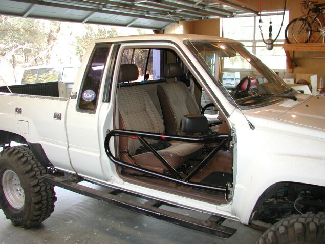

I know it's not a pic of an H2, but they would work well for them. Built using 2x3 .125 wall Mild steel square tube

Old 10-22-2003, 06:12 PM
Cranky,
Do you have different angle and detailed pics?
Looks like a must have or make.

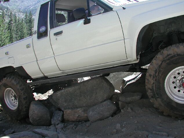

Cranky Steve is an unknown quantity at this point
In this pic, the slider keeps the sheet metal off the door. I have slamed them over and over, and they are strong! Got hit broadside by a Nissan altima, pushed my truck sideways several feet, no damge whatsoever, 5k to the altima!

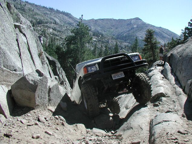

In this pic Drty posted, it looks like the H2 protection is bolted to the frame, making it a breeze to fab heavy duty sliders that sick out just enough to protect the sheetmetal on the bottom of the h2 bodys. Crash, you paying attention here? Dude, you have the fab shop to make these so easy!

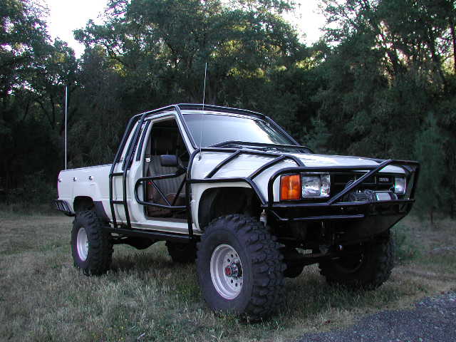

Dennis, I have to dig through my digis to see if I have any good detail shots. Mine are welded directly to my frame with 4 2x3 outriggers on each side. I could have also built them as bolt on just as strong if I had wanted to. My truck is at Rivercity Differentials getting new O-rings in my rear ARB, so I can't shoot any digis today.
Dennis, how's this?

Old 10-22-2003, 06:42 PM
OK OK Me likes
Still admire that custom cage. If you get a chance, a pic of the back end. Looks like a custom ass guard? Nice.

Those are simple, "BUT", they are still hang ups, I wonder if I have any pics of my "body" armor, they REALLY work well, protect the rockers and don't take away clearence. And steve, where is the slide I requested

Ya I like yours as well, but I have had no problem with hangups with mine, they make awsome pivot points.

Cranky,
Who made your sliders? I'd love to hook up with 'em and add some better protection to my ride. Now that I've seen you're rig I'll try to flag you down some time when I see you in P'Ville. I've got a Pewter H2 w/37's and a License plate that says AMA NERD.... We'll have to get together and hit the trail one of these days.

Chris, a buddy of mine and I fabbed them ourselfs. I don't normaly drive the 85 much. Maybe you could come to the next meeting of our club, it's on the last Tuesday of the month at the Round Table Pizza at Madison and Hazel. Check our stie out for details. All are welcome to attend meetings and most runs.
