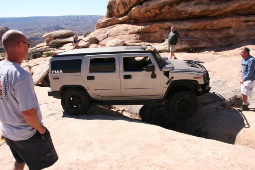

Does anyone have a pic of an H2 WITHOUT a roof rack? I had thought about the same thing to pull into the garage but I think the roof rack is as mandatory as a brush guard.
Mark
Old 11-15-2005, 01:41 AM
<BLOCKQUOTE class="ip-ubbcode-quote"><div class="ip-ubbcode-quote-title">quote:</div><div class="ip-ubbcode-quote-content">Originally posted by OrangeCrush:
Mark </div></BLOCKQUOTE>
Drty has a clean roof.
