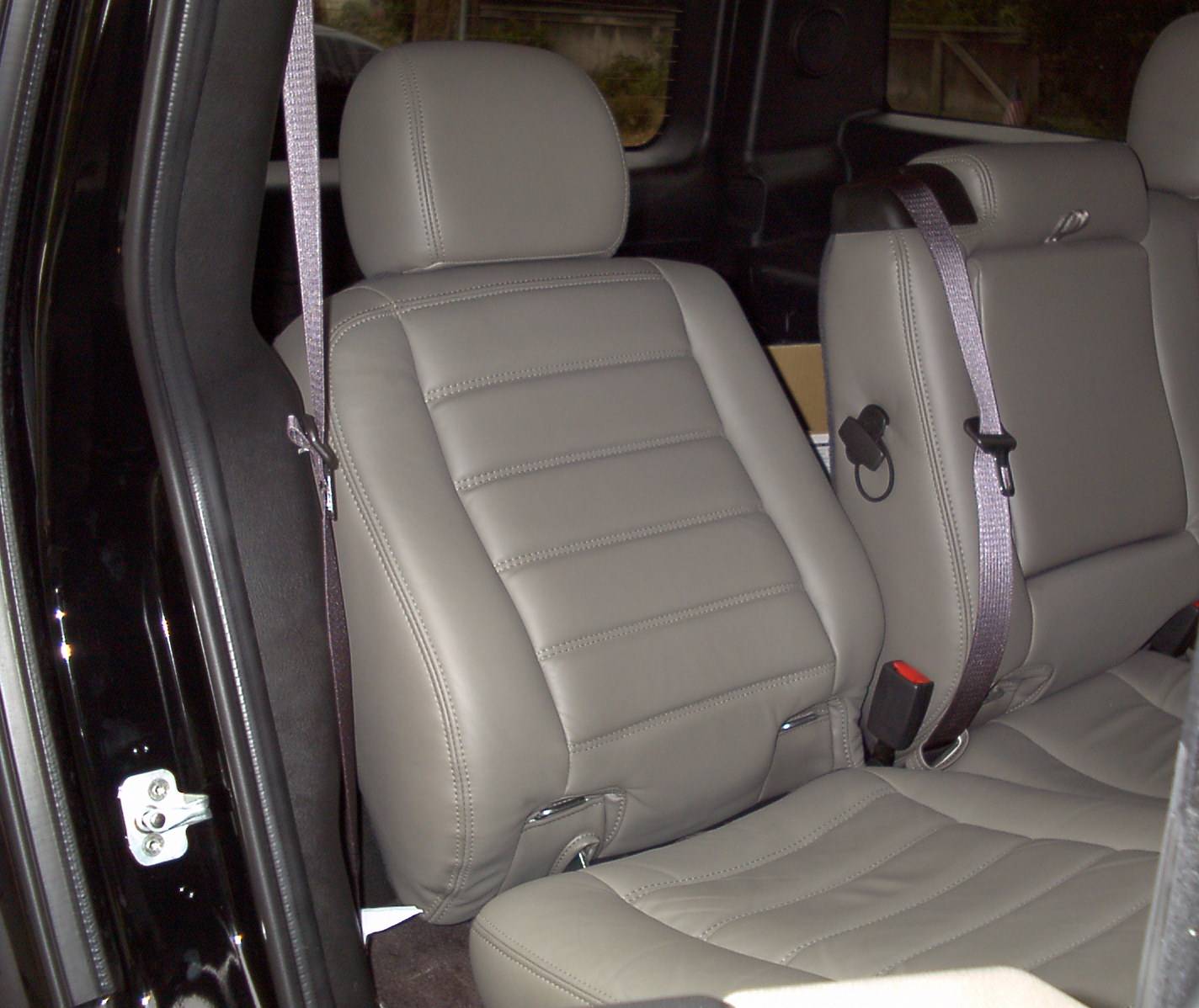

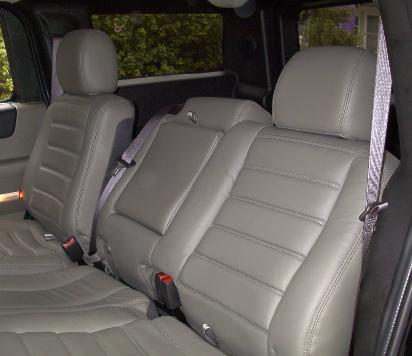

Here are photos of the right seat reclining.

Here's a photo of the left seat reclining

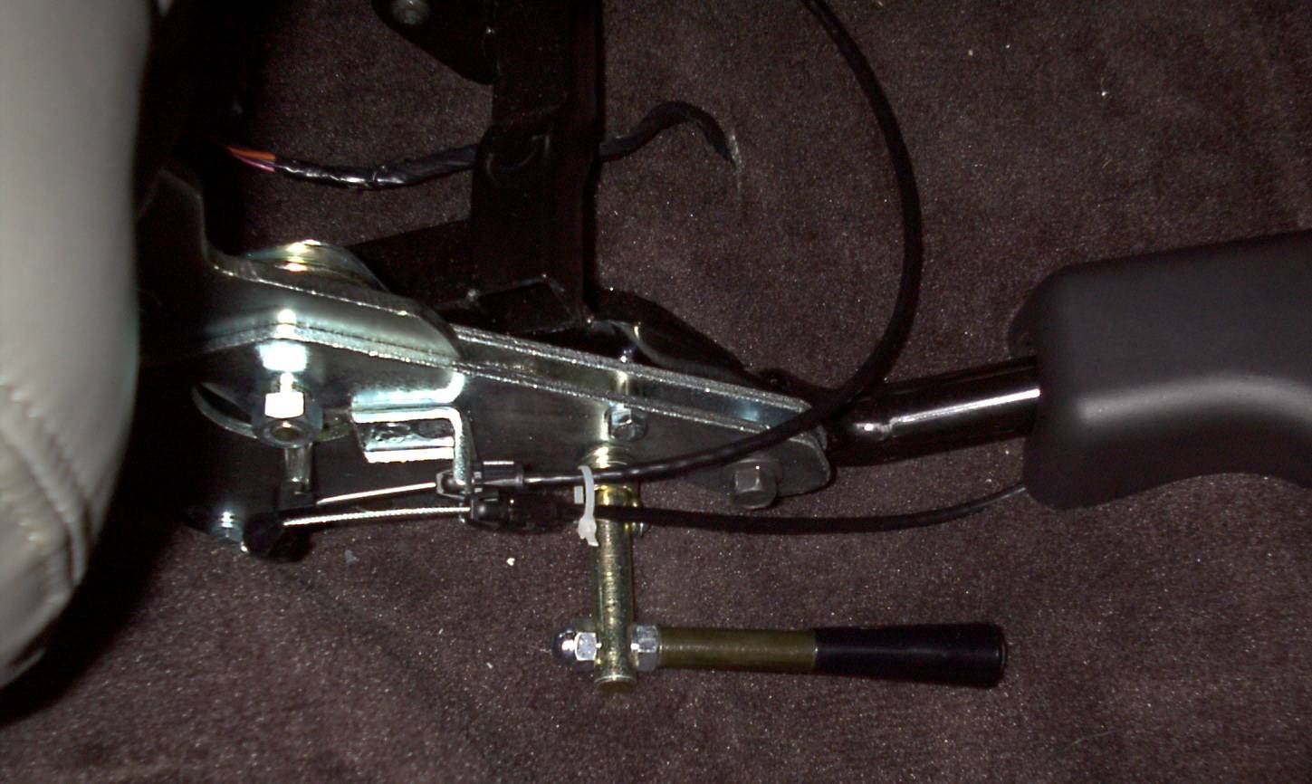

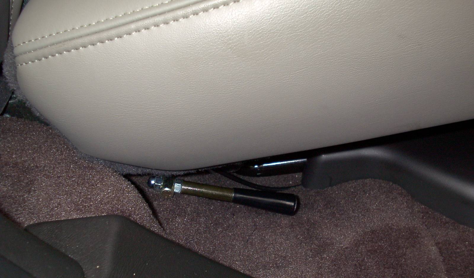

Here's the control lever with the cusion down.
The lever is about 6 inches long.
