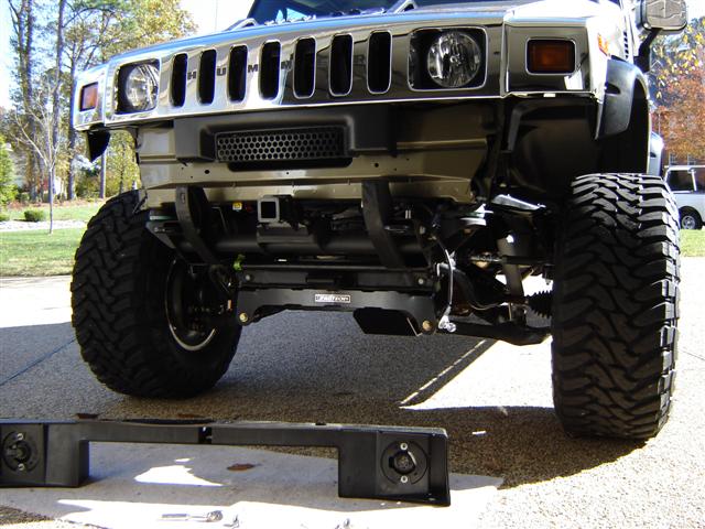

With the old bumper and valance removed. All that was necessary was to remove a few 18mm bolts from the bumper, disconnect the DRL's and slide the bumper off.

Then you remove the front hitch mount and separate the valance from the stock bumper. POC.

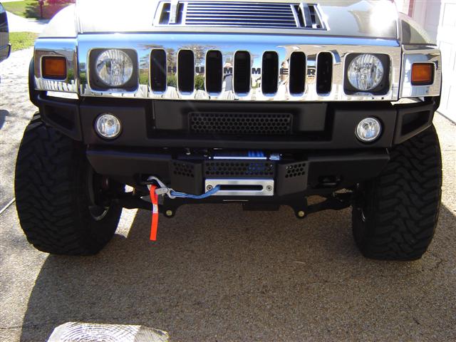

Slide the new bumper on with the supplied 4 washers and loosely attach. Add the faring.
Before mounting the winch you need to remove the cable that came with it because the DRTY bumper comes with a new synthetic line and the cable is heavy.

Attach the winch by sliding it in place and use the supplied nuts and bolts. Run ground cable from winch to the engine compartment.

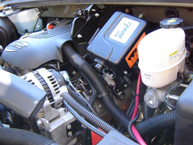

Open hood and attach bracket to hood latch ONE bolt at a time using the new nylock nuts and bolts. Mount control box.
FWIW, I used tin snips to remove some unneeded metal brackets on the back of the box to get a nice flush fit against the new bracket.

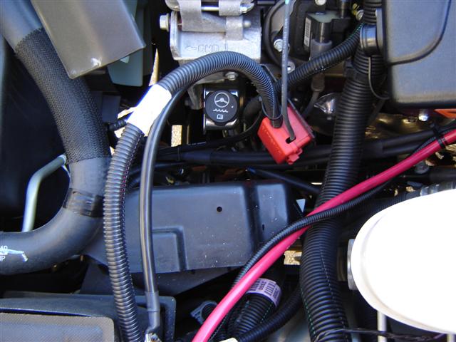

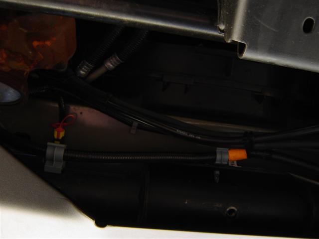

Run cables to winch under the radiator and attach matching the colors. Make sure the cables clear the serpentine belt and will not get tangled in the steering or suspension components. Use zip ties to secure.
Tighten down bumper, but NOT the rear/lower bolts. Those two need to wait.
Attach positive cable, then negative cables not forgetting the small negative from the controller. I needed to make several trips to the autoparts store at this point because my posts weren't long enough. I just bought some adaptors.

Cables under the truck.

The winch is ready to test and respool. Run the new line UNDER the spool and attach to the ground screw. Turn the winch mounted dial 180*.
Have someone run the winch while you pull the line and run it across the spool keeping it taught.
When finished you can begin mounting the valance. You only use four of the original screws and you may want to trim the bottom of the valance above the winch to completely clear it. I started to do this, but screwed up so I just jammed it on and it works fine.

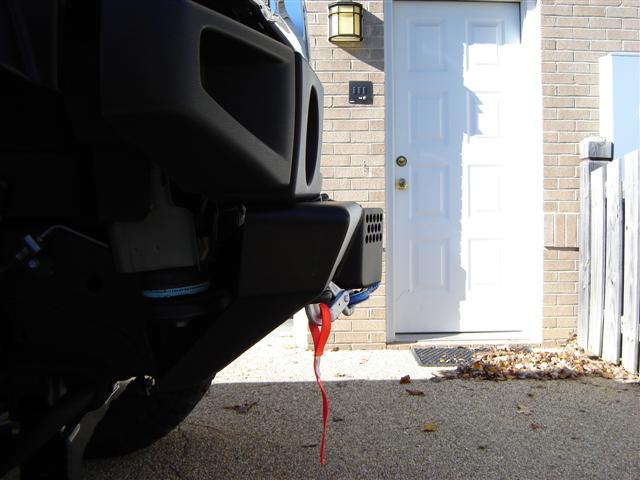

After reconnecting the DRL's you're ready to move on to the hardest part. Attaching the skid plate.
Remove the two, lower rear bumper bolts that should still be loose. Slide the new skid plate into place and attach. Don't forget the big washers that go in between the bumper and the frame.
Now for the hard part, the top, forward most bolts. I just couldn't get the damn things on. My fingers could hardly hold the special nuts that DRTY had made for the application. But finally, I got them on...

Here's a pic of the battery adaptor. You have to carefully pry the factory plastic hood in order to remove the factory bolt. BTW, the bolt is removed easiest by pulling it away from the battery, not toward it.
This adaptor gives you room to mount many electrical devices straight to the battery.
