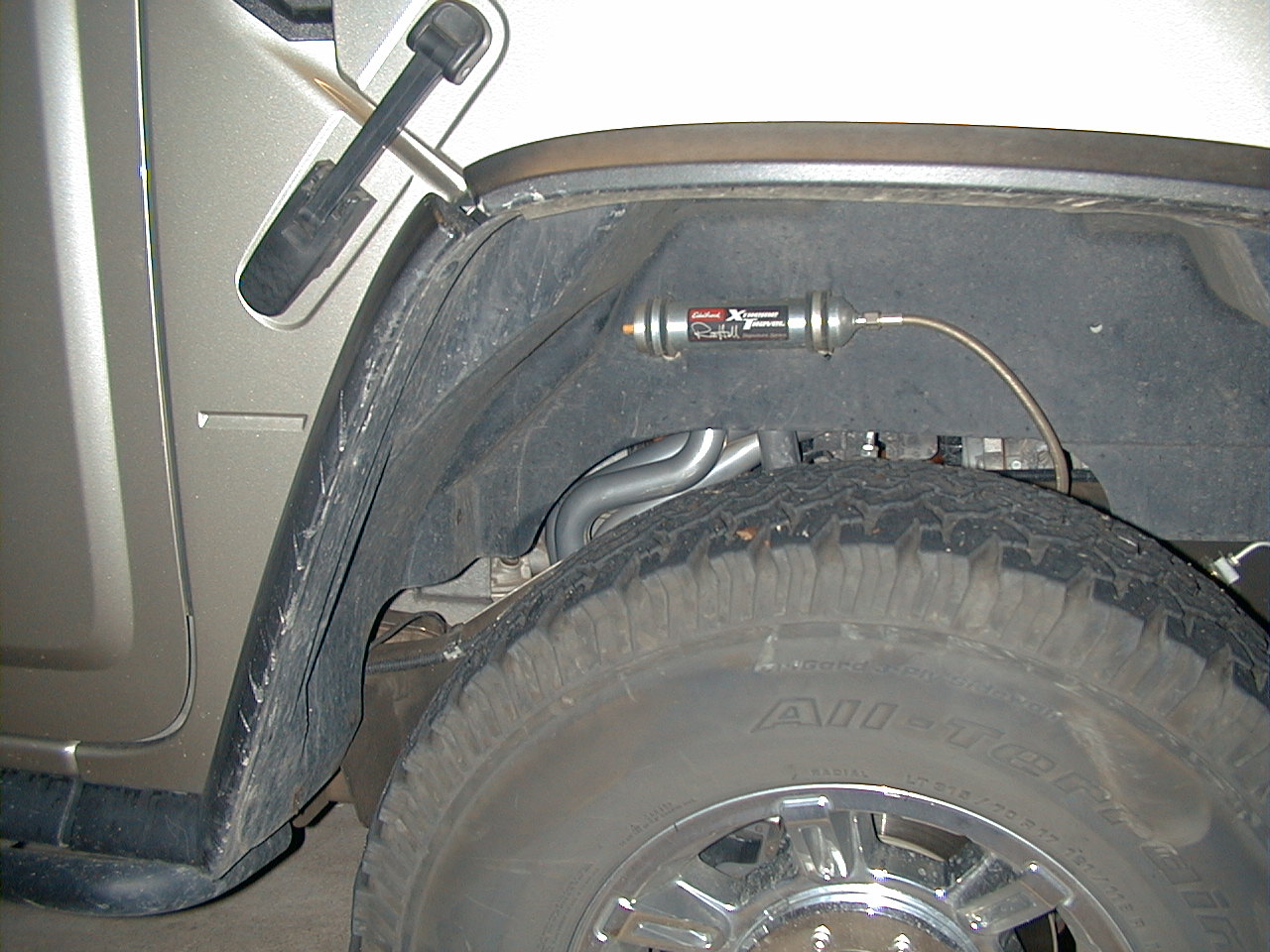

Just a quick shot of the stuff from the left side. Hope it works

How difficult was it to install the headers?
Did you have to reprogram?
Have you noticed a difference in MPG and Power?
Does the shock make a big difference in ride?

Hi Rick, well these are the long tube headers and you have to cut the exsisting pipe to the front on the cat. You then have to assemble it all up and tack weld the flange to the front of the cat. Then you pull the pipes with the cats on them off the truck and do the complete weld. The headers stay on but loose until the final assembly. I have the Volant air bax and a Bassini exhaust on the truck as well. Used the Diablo Pretator to reflash and fine tune the system. Run's on regular gas with no knock retard at WOT. It is so quick it shocks first time riders with me. The shocks are great. Along with the polyurethene busings it handles like a cart. The rebound on the Edlebrocks is very fast, this translates to increased ground contact on bumps and dips on and off road. Pay attention to details and it adds up.

Can you take some more pictures of the cat/header union, and of course some pictures of the nice wheels too.

HI Kevin, will do. I will show you the headers as well. I will do it later today.

What brand are the headers and where did you buy them?
Do you think the extra work of the installation is worth it over the bolt on shorty headers in terms of performance?
Are you using the stock throtle body?
Have you check the improvement on the dyno?

HI David, The shorty headers from all I have learned would not work for my application. I was lookin for low end torque for off road applications as well as launching from a stop. The long tubes give you that. I am sure a good set of shorties are way better then stock if that is the extent of your installation prowess. ( cutting and welding is necessory for the long tubes ) I have not had it on the dyno yet but with a side by side run with a stock H2 I walk away from it like it was in reverse. They are from AZ Speed & Marine they list for 799 or there abouts, I got them for 625 ceramic coated and the flanges. Don't forget to use antiseize on all the bolts in the head. ( aluminum ). Have fun.
