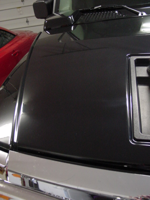

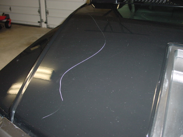

im in macon , i just got both of the scratches fixed , i will post pics in a sec.
1st time)
after)

1st time)

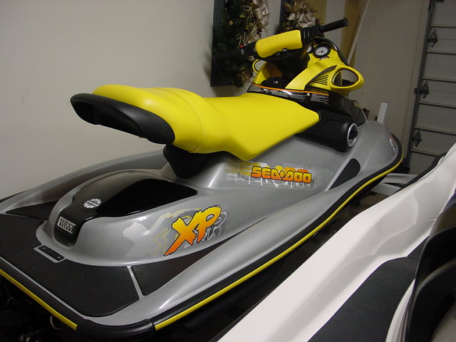

my jetski out of the water i pull
on the way to the Tennessee vs. Georgia game in athens

jetski

Nice ride. I had an XP Limited a couple of years back and had a blast on it! Change the sponsons and the intake grate and thing really goes and handles great.
