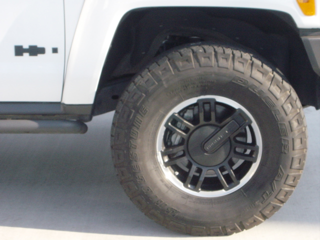

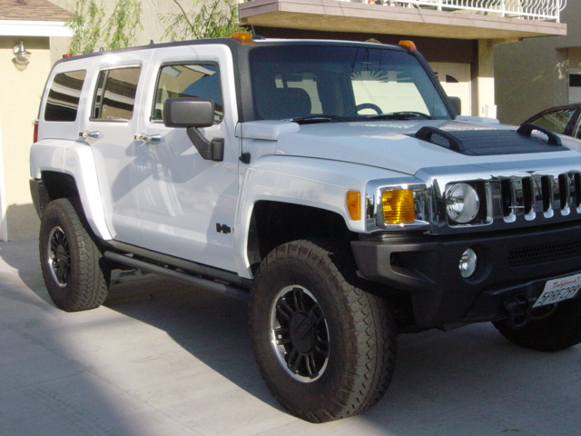

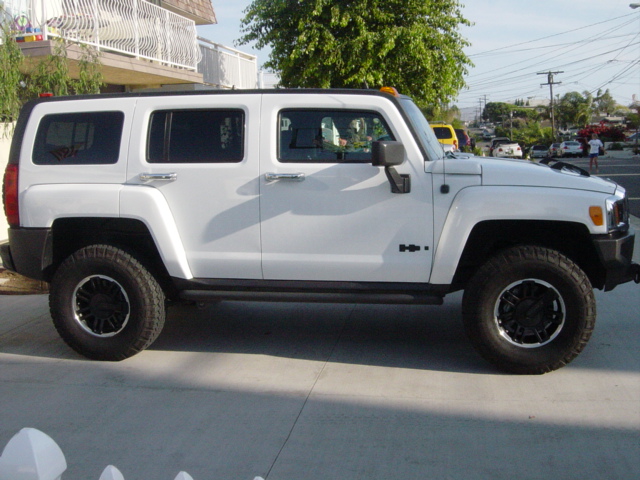

I had to leave a little BLING. Sorry guys and gals

If you have to have some...you left the perfect amount.
Nice!

Hey, how did you do that?
Old 05-28-2006, 02:43 AM
Default Re: Because I'll never be a true HOABie
The wheels turned out nice! Did you have them PCed or jsu paint them?
Old 05-28-2006, 02:53 AM
hmrlvr's Avatar
hmrlvr hmrlvr is offline
Posts: 1,204
For now, just paint. I'll see how they hold up. I'm waiting for these
Old 05-28-2006, 03:01 AM
Very cool! I love those rims, if I ever crapcan the stocks those are what I am getting!

Nice looking truck, It looks good

How did you paint them? Spray paint? I like the black and was thinking about the powder coat but was thinkin *cheap*. Anybody know how much PC'ing is?
TGL powder coated his. Neo painted his. I'm sure powder coat will hold up better but you can't beat the price for a couple cans of paint.
Old 05-28-2006, 04:31 AM
Looks nice, I was thinking of doing something like that, but it was easier to just tell the PC'er to make them all black.
Lang - It's about $50-$125/wheel to PC. Places around here charged $100/wheel.

wow looking good man !!!!!!!!!! i like the way you did the wheels with the polished lip , looks real custom with the emblems we can always forgive you for alittle bling looking sweet !!!!!!

Do you even have to take the wheel off to do this? It looks like an easy & cheap job and i really like how it looks. My plain stock ones are buggin me.
Old 05-28-2006, 05:27 AM
hey lord , its best to remove wheel and tire from truck to avoid overspray on your paint . but no need to remove tire from wheel . i painted all my center caps and spare on a fri night and did the other four wheels on a sat . just scuff the clear coat with a scotch brite pad . tape off the tire at the bead and spray away
Old 05-28-2006, 05:30 AM
one other thing i thought of after doing mine , you might try it , is get self etching primer and then paint over the primer might hold up better

Cool thanks a lot. This will give me something to do on Monday!
Old 05-28-2006, 07:16 AM
X2, I was thinking the same!!! Will you get mad if I do the same to my wheels???
Old 05-28-2006, 03:00 PM
hmrlvr's Avatar
Posts: 1,204
Do it!!! And, I would definatly pull the wheels off the truck.
