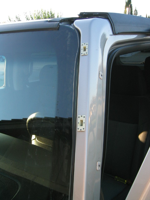

The kit included an 18' fireflex cable. I ran the cable down the A-pillar and behind the quarter panel. I had to clip the A-pillar trim a little so it would sit flat with the cable running through.

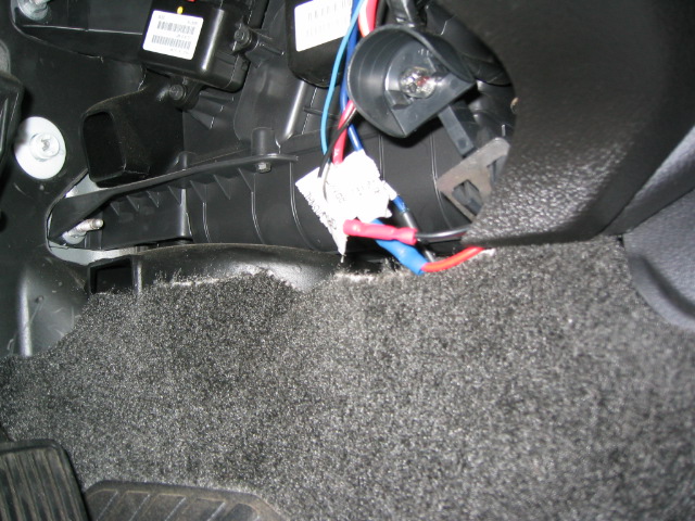

I tapped into an existing aux. line (Aux. B+) and ground under the dash. It is not switched so the CB can work without the key in the ignition.

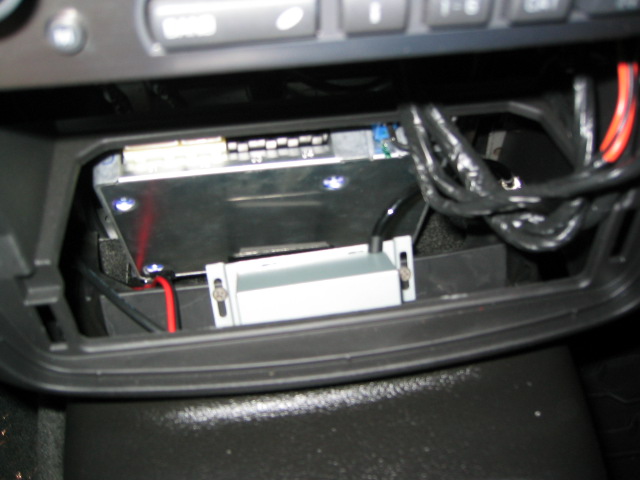

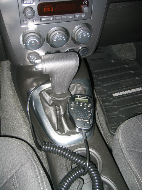

I mounted the remote unit inside the center console and tucked the excess cables underneath the center trim. The pigtail for the mic fits through a gap in the console and hangs out the passenger side.
Old 10-24-2005, 03:22 AM
A pic of everything put back together.

looks great, I will do the same where you put the unit inside the center console, but how did you remove the face cover of the center console? and if you could give us more detail on how did you tap the power?...thanks.

The face plate is held in with clips. Move the shifter all the way back, stick your fingers in the aux outlets and pull up/out. There are about 4-5 plugs you have to remove to get it all the way out.
For the power, the wires should all be labeled. They were bundled just above the light you see in the picture.
One note about that mounting location. Make sure you tune your antenna before you mount the box since it is pretty hard to get to afterwards.

Hey bud, how did you get your a pillers off? Thanks for the pictures looks great man!

Pull the rubber door seal back and there are two screws on the side.
