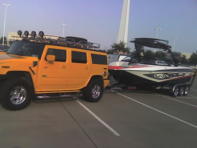

Ok, I have read the threads about all of the recommended shocks. I am leaning towards the Rancho 9000 adjustables. But as you can see by the pic, I trailer a heavy boat that drags down the rear of my H2. I do not have the air suspension.
Will I sink even more when I replace the stock shocks with the Rancho's or is there a better shock to use.
Anti-Blingers please go easy on me.
Sorry about the quality of the pic as it is from my camera phone.

First, are you using a weight distribution hitch? Second, I too do not have the factory air system but I installed an aftermarket air bag system. It was cheap and works great for what it is.

The Ranchos set on 9 may help. If not, you could always roll the boat back a few feet to relieve tongue weight.

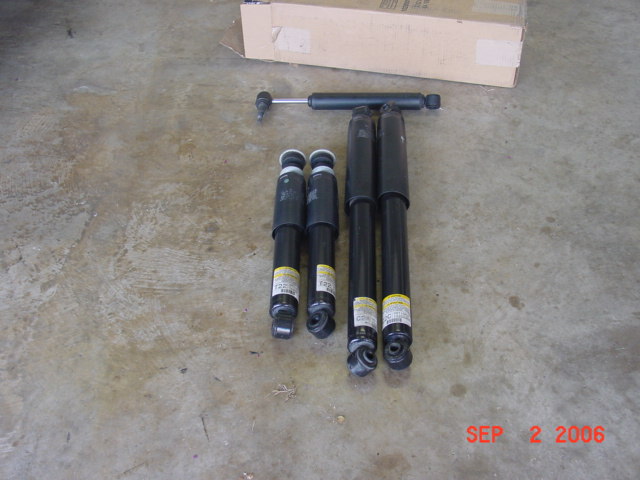

Looks like your air bag sys is not able to support all of the tongue weight. Because of this, I wouldn't jump right into swapping out the high pressure OEM shocks for non-pressurized shocks as are the 9000s.

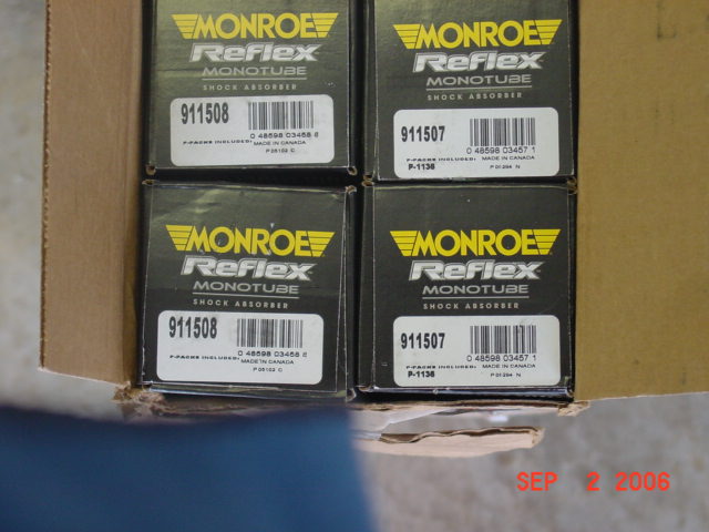

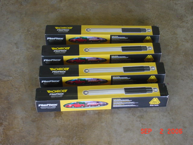

Go with Rod Hall Hummer shocks or Monroe (self adjusting shock) or the Rancho RSX shocks (self adjusting shock) - both of which are high pressure. Rancho/Monroe are the same company so these are the same shocks with differnent appearance on outside. Rancho/Monroe also make the OEM Hummer shocks.
If you OEM shocks are worn out, I have some OEM ones with low miles. I also have a brand new set of never opened Monroe Self adjusting shocks for the H2. The are brand new in sealed boxes. About to list them on ebay of you want them let me know ASAP.
Any shock that is not high pressure 285-300psi may cost you some ride height, as they appear to assist the H2's height.
Try keeping boat a little further back on trailer.

OEM with sterring stabilizer

Monroe self-adjusting

Shocks are not your first concern. You need to consider how you are going to handle the tongue weight of the trailer. Since you do not have air there are a few options. A weight distributing hitch is an option as it will (if properly set) keep the vehicle ride height even. Second you could do some secondary or even primary air bag systems that replace the coils such as the ones Firestone make. Thirdly you could add air shocks that work off a compressor to add additonal carrying capacity on an as needed basis but operate as a normal shock.
Aside from option 3, the shocks will just change your vehicle ride characteristics. They may change the height at which your truck will sit when sitting still but that's simply an aesthetic concern if you're accomodating the functional concerns.
Lastly, if you going to pull much, dump the H2 and buy one with rear air. Truly makes all the difference in the world.

First Off!....Need to know the LOADED Weight (full tank also) of the Boat And Trailer....Then You need to know the "Actual " Tongue weight--
If your not, OVER the Towing Capacity of the H2, I'd suggest moving the Boat...Back on the Trailer....until the correct Tongue weight is achieved....(lighter side of the Range--2,3,4oo#) J an O ...Well, something I've done anyway
Get the 9000's! Their a great shock.....and not you problem!

The boat weighs 4,000lbs with a 87 gal tank, that would be roughly 4,700lbs with full tank.
I have no clue how to figure out the actual tongue weight (any suggestions) and I would have thought that the triple axle trailer would eleviate some of the tongue weight.
As far as moving the boat back on the trailer, Get Real

Check out the weight distributing hitch or air bags.
Going back to my drag racing days, we had air bags in the rear coils that could be inflated to any pressure we needed to limit launch squat. That type of very inexpensive system should work for you.

Also if you notice, the graphics on the boat make it appear as though the boat is leaning forward, just an optical illusion.

I am Real! ...How Do you think the Tongue is Adjusted!...Sheesh! Take your outfit by an RV dealer...They should have a Ball Scale!..They really have such things!....Or Buy One!

BTW, roll the boat back so the transom is about 6" off the ground. I promise that'll work.
