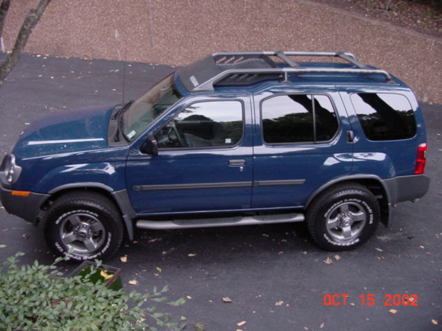

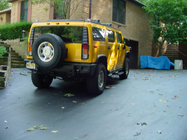

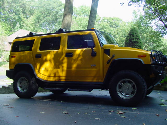

I've had 3 H2s. If you look on the member list I'm the third H2 there, name, Jrbbikerx.
here is the same pic, full size. 2nd one taken the same day, different angle. the last is the X we used to have that was wheeled with the h2 before it was rolled

the X in all its glory
