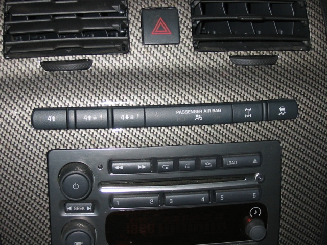

Hi everyone, thanks for the input. The button was not pressed by accident. It is flashing on the button itself. I also noticed to day that everytime I start my truck, it flashes for a few seconds. I can engage it if I am in 4 low, and the light stays on.

Which of these buttons was flashing? The last one on the right is Stabilitrac. The 2nd from the right is the locking rear diff.

Maybe the plugs not cliped in properly behind the panel,pop it off and take a look.
Stick your fingers in the sockets and pull/yank upwards then work your way around panel top vents will come off with panel.
Carbon fiber =
Good point, but I would pull from the top (use a thin plastic tool or spoon to pulle away the top from the I/P). Then make sure all the connectors are plugged in.
If not, I would have the dealer check for a code.
