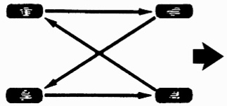

What the manual says...if you have a bidirectional tires and want to follow convention, fronts crossover to back and backs go straightforward. People have their reasons for not doing it this way, but it's what's recommended for the BFG tires.
To rotate the fifth in, just pick a corner any corner and whenever you rotate put the spare there and take the tire that would have gone to that corner and make it the new spare.
