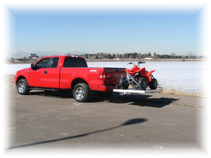

Heres whta im having made,no pics yet though.im having an extension come out of receiver to just pass the tailgate when its down and then a riser bar up flush with the tailgate wich has a platform on it as wide as tailgate but only 2feet longer .If you have your quad in the back it only needs to support the back wheels(or front depends on which way you load).im also having strap on it to attatch to the tie down brackets in the bed so it doesnt stress so much when loading.Spare tire goes on a custom made receiver on the front of truck.and my ramps will slide right under the quad.

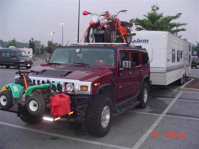

I found this picture of a member here from a while back.
Name:  06 Romp 004 (Small).jpg
2005 H2 SUT Lux *sold*

I was considering something like that but didnt want to killl myself putting my atv on the roof.
