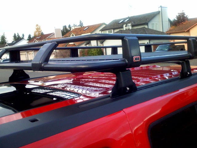

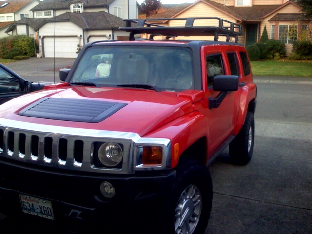

Just installed my arb roof rack last night. Used factory track and arb fit kit for a Jeep Cherokee gutter. There should be a actual h3 fit kit out in the future, but this works for now.
