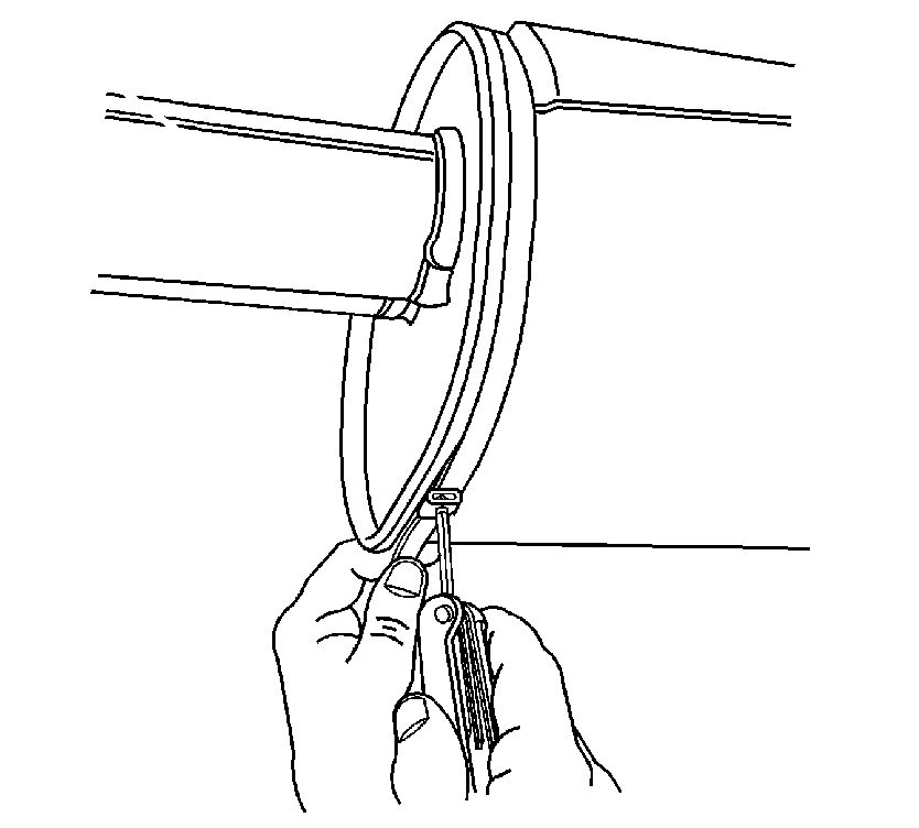

I recall awhile back aboot RATTLE in the muffler or cat by some of the Furom members. Apperantly there was a fix (strapping) to it.
Has anyone had this fix??? If so can anyone take a PICTURE of theirs? Mabye it's something I can do myself instead of bringing it back to the dealership.

I had two muffler problems, and one was exactly what you are talking about. It made deep vibrating/rattling sounds particularily when going slow with some torque applied. The easiest way for me to replicate it for the dealer was to slightly press the brake while slightly pressing the accelerater (while in Drive).
I can't take a photo for you but I can give the explanation I received from the dealer. They said that it was some sort of plate over (on top) of the muffler. Apparently this "plate" is very close to some other metal (maybe the top of the muffler itself) and that if it gets slightly out of aligmnent/loose then it vibrates against the muffler). They said the design is such that there is a very small amount of space when mounted correctly so a slight offset of the plate will cause it to rattle against the muffler.
The fix is quick as it only took them a few minutes to adjust it. So, I suspect you could do it yourself. My belief is that it happened when they were fixing a separate 'pinging' problem in my muffler. The tolerances (distances) of the moutings are so tight that when they reinsalled by muffler they just messed up the placement by a couple of mm.

TSB:

Old 10-17-2003, 08:56 PM
Klaus,
I was PRAYING you would respond. That was it.

Old 10-18-2003, 12:12 AM
Klaus's Avatar
Klaus Klaus is offline
Location: CSA
Posts: 2,511
Here's the picture from the TSB:

Old 10-18-2003, 01:04 AM
Klaus,
Thanks for comming through for me. Many thanks, that`s exactly what I need.

Old 10-18-2003, 04:08 AM
Join Date: Jun 2003
Location: L.A. California
Posts: 959
Dennis,
It's not always the heat shield. I had the same rattle that would occur at low rpms. It turned out my offroad trips had pushed the front protective cage up into a portio of the exhaust causing it to rattle. The dealer bent it back out and put a couple shims (spelling?) to give it a little more distance, so I'm sure it's one of these two fixes. Just know that when I went to the dealer they assumed it was the heat shield but it turned out to be due to the offroading.
