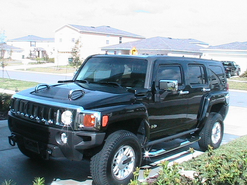

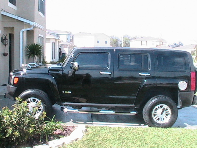

Yeah all went well. I know nothing about vehicles and it took me maybe 30 min to take off & 30 min to put on.

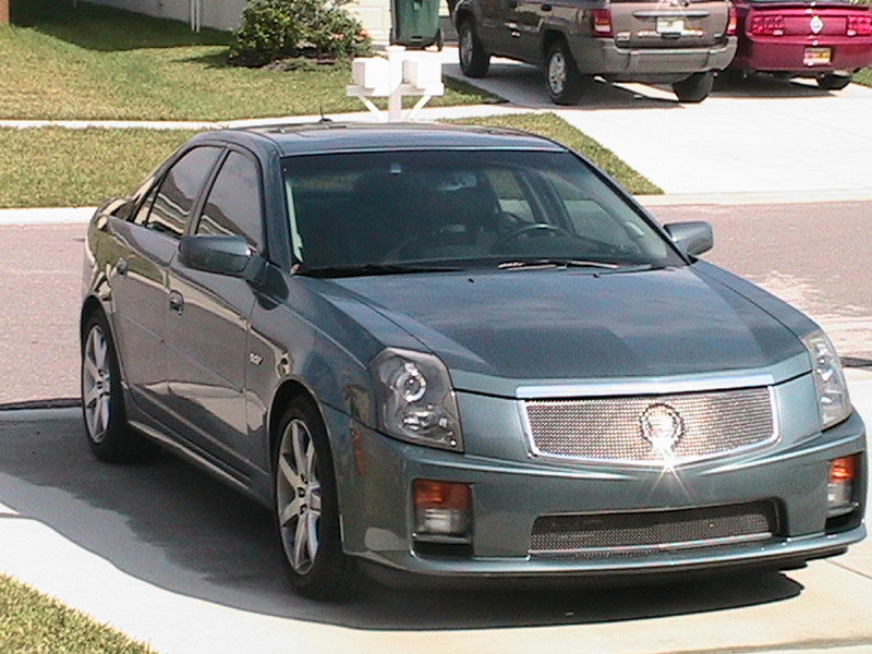

Heres pics.. Yeah my hood handles are weird -- my wife bought them and they sent the wrong ones. But we were too lazy and didn't return them in time. Threw wifeys CTS-V in there too. Sunny Florida.

Looks like your hood handles were on backward! Looking good though!
