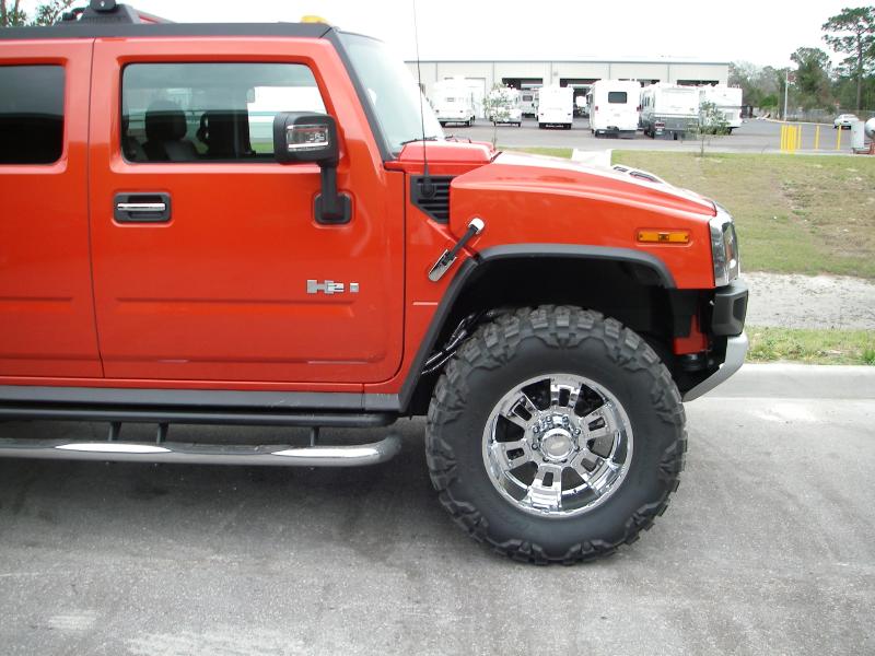

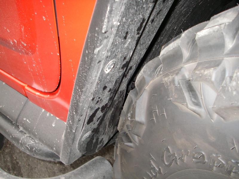

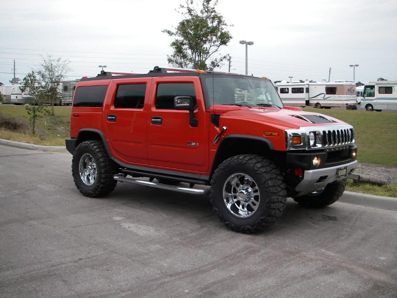

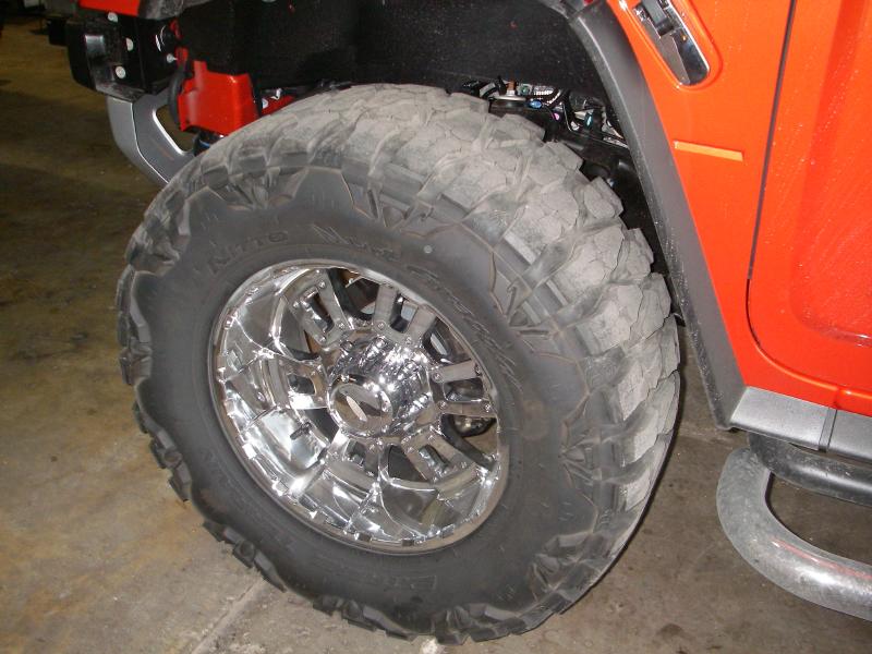

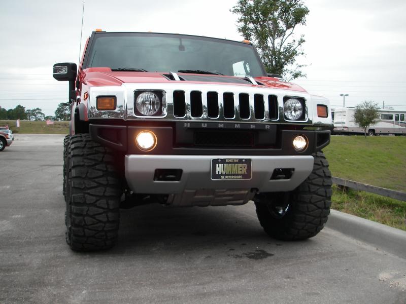

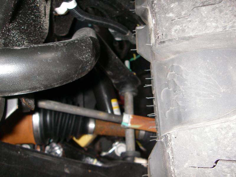

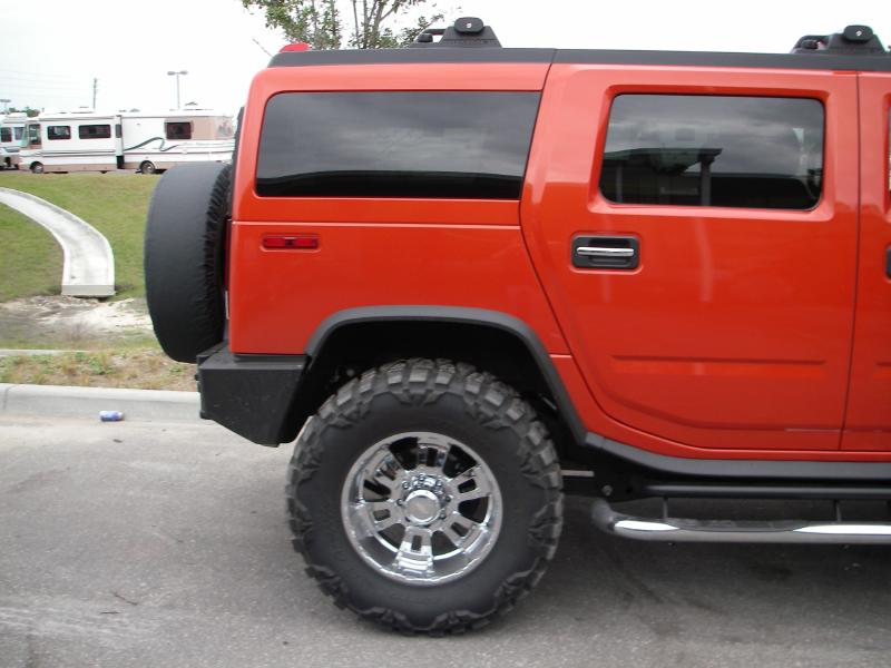

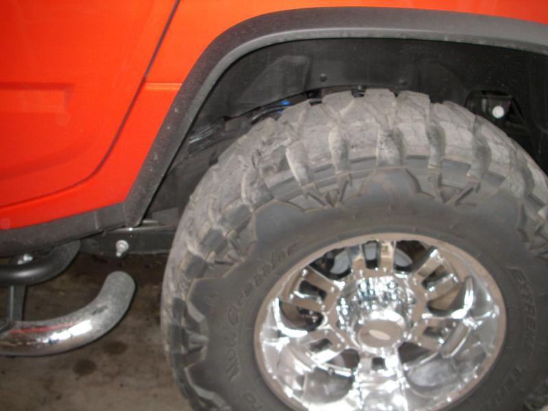

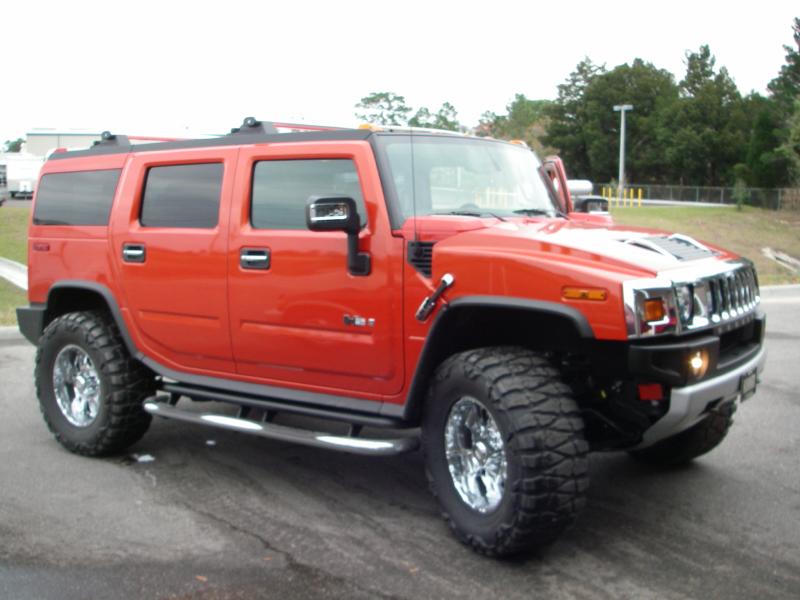

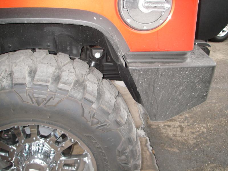

I found them 38x15.50x20 - stock truck - a little tweaking to the T-bar.
You can see a little rubbing on the sway bar and the plastic inner fender. That was with the wheel at full lock

I don't know about running 38's but I ran the 37in. grapplers and used the torsion keys with very little rubbing at all.
