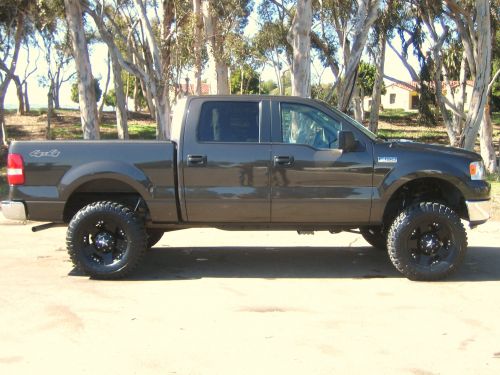

Picture this but my H3T on top...

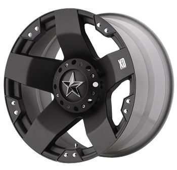

here's a picture of the wheels too...
