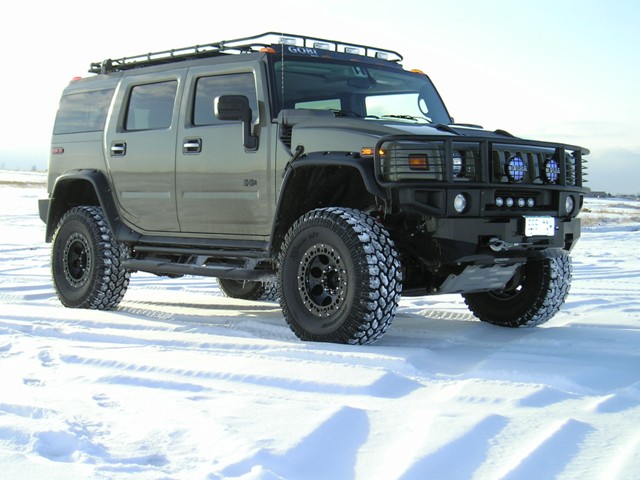

MT tires + ice = ditch. sipe the center lugs and you're not too bad off though. OR try a MT with some siping like the Toyo MT or Procomp Extreme MT. not great on ice either, but not too bad in snow. I ran the Toyos on the last H2 and they were "ok" but ice was not fun. The PCE MT's I ran last winter on my ALpha and they did great..but agian not so good on ice. you need a siped tire to handle ice/snow better.
if you want a more aggressive tire over teh BFG AT, try the Procomp Extreme AT. I have ran those on a couple truck and had great luck in ice/snow and wheeling.

Sick wheels...who makes those?
Old 08-03-2009, 03:45 AM
Default Re: are km2,s good in snow/ice
ProComp 8179.
http://www.procomptires.com/truck-je...79-wheels.aspx
and than you add the extreme rings.
