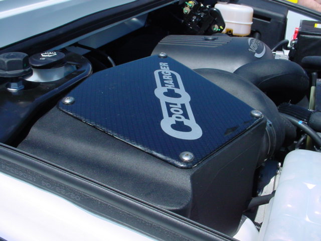

The dealer I bought my H2 from is installing coolcharger system with full factory warranty
* Approximate rating - 450/horsepower 550/ ft.lbs.(@flywheel) torque vs. stock rating of 316/360!!!
http://www.dyno-proven.com/coolcharger.htm

I never drove it because I was afraid I would want it on mine.

Actually, when installed by an authorized dealer, they come complete with a supplemental warranty that “mirrors” the factory coverage. I am not sure what that does to the factory warranty??
