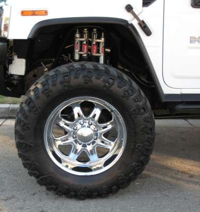

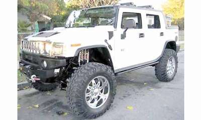

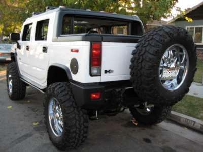

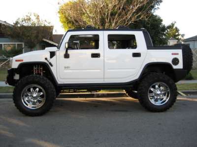

You can get about 7'ish " out of a 6" lift by cranking the torsion bars a bit. The max tires are 38's (though I have heard of people using 40's... not sure how but that's what I've read)
If you don't have to worry about parking garages, home garages, etc ,etc, I'd go with a 9" lift.
The ONLY problem IMO is when you raise the truck that much, you need the right size tires with it.
The problem with that is the H2 SUCKS powerwise with a set of 38's unless you supercharge it and even at that, it's not all that great. I can't imagine how terrible it would be with 40's, nevermind anything larger.

It will clear 40's and yes you can add 2" torsion keys and 2" spacers to it without a hitch. I am running 37's on mine but I am just waiting to wear them down and throw on the 40's super swamper m-16's. Also you will definently lose power so I am also doing re-gearing for the 40's.

I looked around and search the web these are some H2 with 6" lift kits with 41" tires looks cool
http://www.nationalvehicles.com/view...sting_id=70480 41" tires
http://www.cardomain.com/ride/3106311 38" tires

If your going to go with 40's you will need gearing. That transmission will not last very long pulling all that weight forward and your power curve will go to hell not to mention your gas mileage will be horrendous. Maybe 5 MPG lol!! My plans for mine are re-gearing, a shift kit, and a tranny cooler. That should keep the tranny gremlins at bay. Thanks for the comments on my rig!! I'm getting rid of the chrome to go with a black and orange theme. Hopefully works out!!
