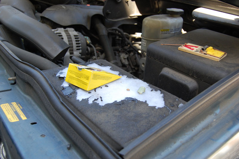

Ok he set off one of the traps then took a crap all over it.... seems as if he is flipping me the bird at this point.

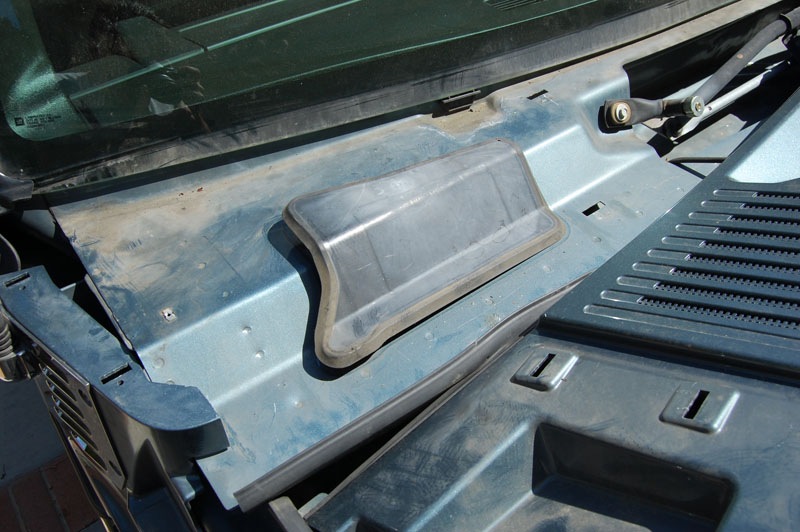

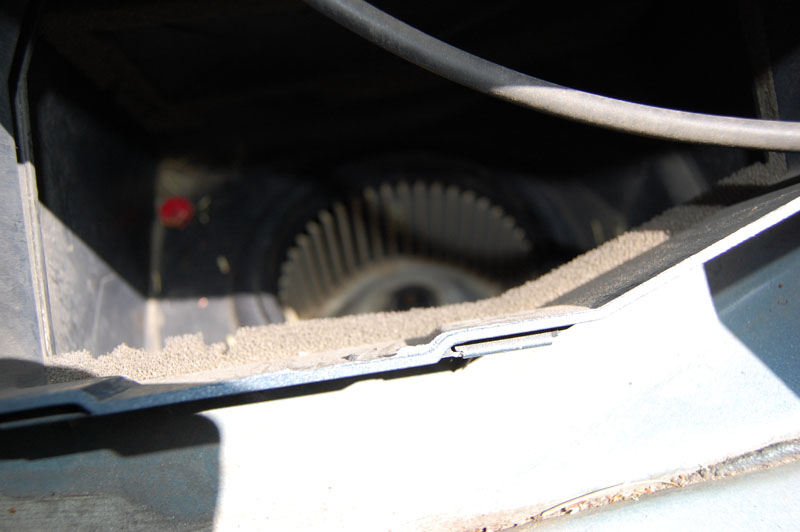

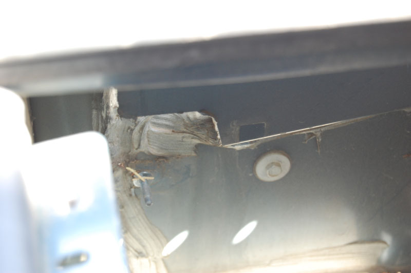

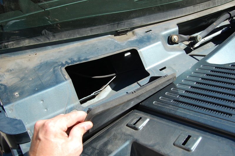

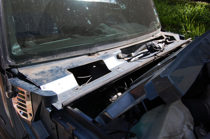

OK guys I found the inlet and it is right on top of the motor..the little ****s are coming up the wheel well and (if you look under the hood to the left side of the washer bottle) there is a square end which is open straight into the front firewall)
Removed the complete top panel (the panel thats goes end to end below the windshield). Once removed there is a black cover which goes over the motor.
Full of branches and twigs... now that being said teh cover doesnt ahve a hole in it !!!
so there is till a little mystery as yet.
they have been eating the joint sealer as I can see that scraped away.
will take some pictures and see if I can post them.
because no doubt someone else will have the problem.

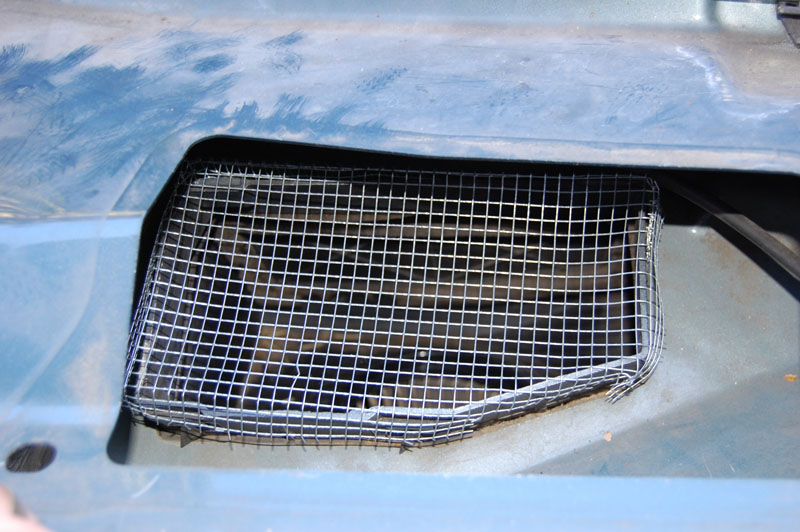

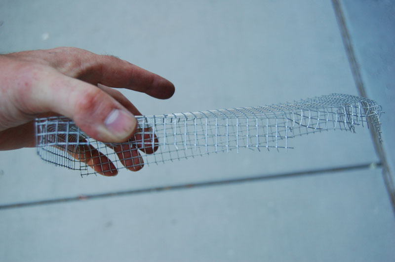

CONCLUSION !!!!
hopefully the pictures turn out.

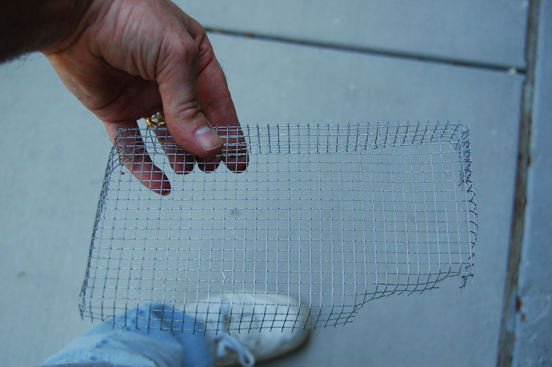

found the problem, found how they were getting in... turns out there is nothing to stop them going right into the motor.
my fix .... made a wire mesh cage/ cover. covered the intake hole for fan and the two water drains from the landing panel.....
water can still get out... i used a 1/4 mesh from Home depot.
hope it helps.

ok here are the pic... i think

I wanted to reach out and say thank you for your detailed description and pictures of the mouse nest in your blower on your H2. I had the same issue on my 2005 H2 and was about to get the blower replaced until I saw your post. Once I saw your pictures I knew that crazy vibration had to be a mouse. Low and behold there was a mouse that had the fastest hamster wheel ride of his life. He was stuck in the fins on one side which is why it was so off balance.
With your pictures I had the job done in 1 hour.
