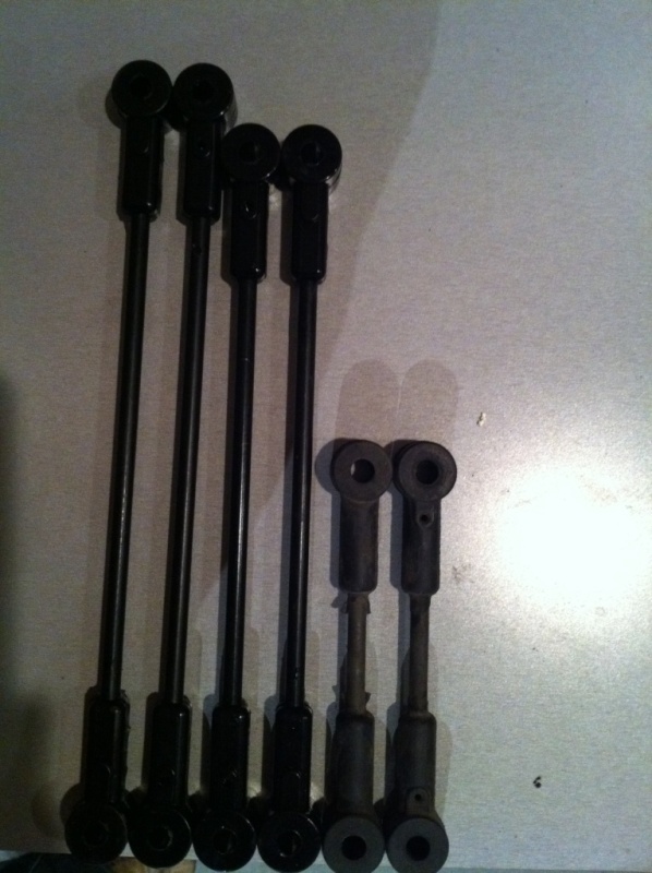

I have a Rancho lift with "Long" air ride sensor links that I'm going to replace with there "short" links. Can you guys give me step by step instructions on how to change out the links?
Here is a picture of the Long, Short, Factory links!

I installed the Rancho "short" links and my SUT was lowered just over 2".
With the long links I measured from the ground to the fender and my truck sat 50.5" at each corner. With the short links my truck sit's at 48" at each corner. I uncranked my torsion bars and my SUT rides very smooth now but I do need to get an alignment. I also rub when at full crank and would rub bad offroad! Hope this info helps you guys.

First pic is Rancho's LONG link
Second is Rancho's SHORT link
