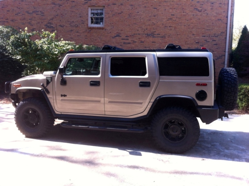

Hey guys, just want to share some stuff that i did to my truck....still to do some fine tuning to get rid of a slight rubbing on the frame while on full turn
Stock 35"
38" tires installed
Tires, rims and wide off-road fender flares installed. Cranked the TB 1.5", i will replaced them with the GM green keys to get the full 2" lift and install 1.5" rear spacer. Rides a little noiser compare to the stock BFG's but hey, not bad for MT tires. Ordered the front Cognito UCA, steering support bracket and 4 longer Bilstein shocks.

wow thaat exactly the look i would like for my truck.
at least for now
(well and minus the rockstars)
where did you get the fender flares and does your truck sit level?
Do you have air ride still in the back?
Oh btw, what is your ground to top of roof rack measurement?
I hope to hear good numbers since i actually have a clearance issue I will have to deal with
it is nice to have someone already doing this so I could find out and not end up making a very bad and costly mistake

I got the fender flares from Hummer Parts Club, i found that they have the lowest price. My truck sits pretty much level...i took the measurements from the ground to the lower lip of the fender flares....front: 43.5" rear: 44". I just installed 1.5" rear coil spring spacer. No air suspension. Planning to install gm green keys in few days.
Ok, it measured 7'1" from the ground to the top of the rear crossbars since the rear of my truck sits 1/2" higher than the front.
Hope this helps!

When you measure the height of your truck, use that crease that runs down the doors for your measurements...each end of the crease. I realize the crease is not toward the ends of the vehicle, but the fenders are cut differently front to rear. They are not the same height from the ground, even if your truck was sitting on its frame with no wheels, tires, suspension, etc.
Truck looks great, btw!

wow, those 38's fill the wheel well up nicely....
im starting to shop for new tires, and have been thinking of the Toyo's MT.
currently running 37 BFG MT, and have a spare i never used... but i like the idea of throwing 38's under there without a lift ( other than keys)
btw.. good thing you have your tires chaulked in the first pic.. glad to see safety being used!

Are those tires the 38x13.50 or the 38x15.50? The truck looks great! My 37x13.50 Toyo MT's have another year or so left and I've been considering going larger too.
