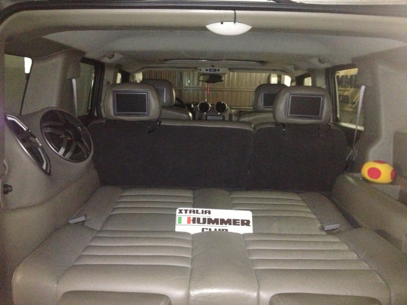

My in Italy!
the amplifier is installed under the subwoofer
'03 H2-Hipertech progr-Add gauges-Cooper DiscoSTT 37x12.5x17-Pirelli PZero 315/40R26-DUB DirtyDog26x10-Sport brake disc rotor-Stainless brake hose-FAB in/out TR-MOOG up/low BJ pitman idler-HD swaybar links-increased oil sump-MSD-Rancho9000XL-Rancho steering-Ring&Pinion4.56AxleRatio-BBKheaders-Magnaflow Cat&Exhaust-AiraidAirIntake-3"Fenders-1"Spacers-LE BullBar-LightBarDelta10x-AMP Powerstep-5LCDscreen-Navi-PlayStation-DVD-RearCamera-f&r parking sensors-All LED&Xeno f&r
from italiahummerclub.com

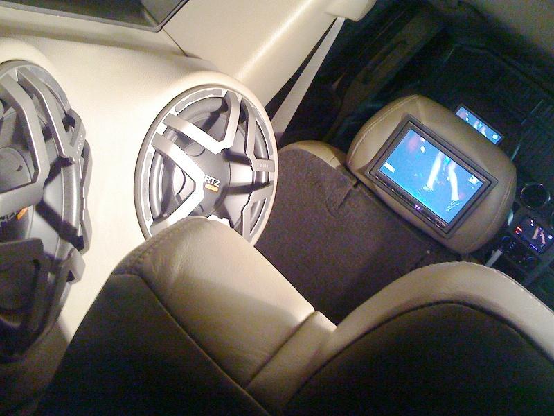

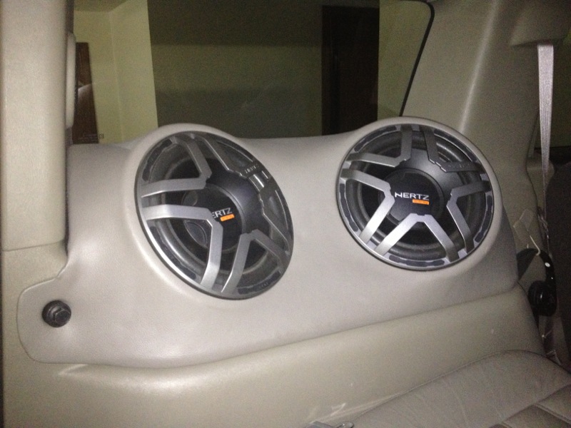

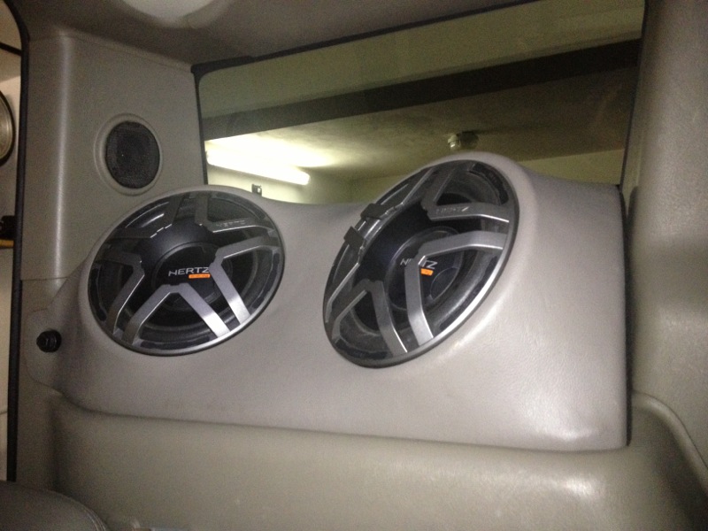

Originally Posted by Hellz
can you post some better pics that shows the whole side please?
Hi,
Also at the beginning I had a subwoofer as smileynialley, then later on I did this.
has not been performed no hole, for fastening have been used the two bolts of the wheel support: one external and the other internal to the subwoofer. hand made, built in fiberglass and MDF and covered in leather.
