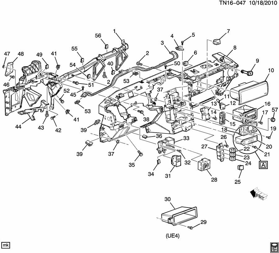

There was an actual GM part made for trucks without the OnStar...but I never seen one. Part #15200468, COMPARTMENT, Instrument Panel
http://parts.nalleygmc.com/showAssem...=0&modelYear=0
It's number 30 in the image below:

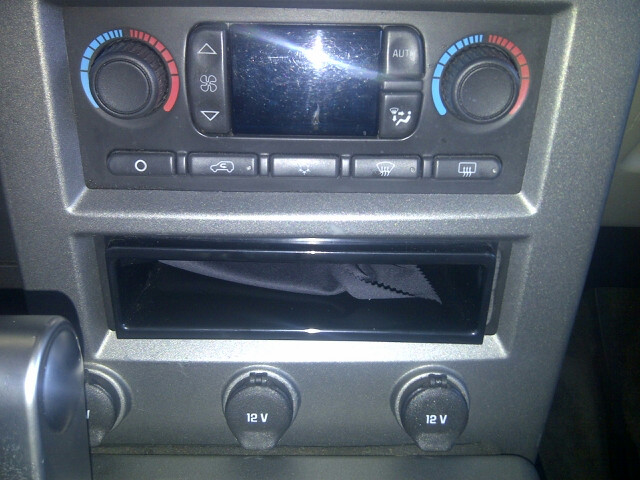

Actually I ordered mine last year after a similar discussion come up.
I have mine sitting in the garage waiting for my lazy ass to finish my stereo install.
So they are available
