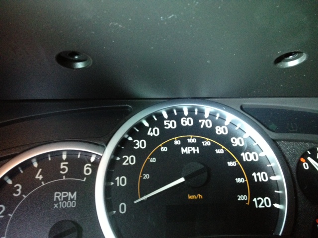

Does anyone know what size the screws are above the instrument cluster or what the part number would be for them? I am missing both of them.

I believe they're just standard sheet metal screws. There should be clips the screws go into. Maybe 1/2" long if that.

LoJac963 is right, Just took one out and measured it and this is what I came up with. Around 3/4" long though.
http://www.clipsandfasteners.com/4_2...w_p/a12060.htm

Thread count and pitch would not matter nearly as much when screwing into a standard clip. If you were trying to match an actual bolt then yes the count and pitch would definitely matter.
For these you could literally hit up any auto parts store and buy a pack of screws off the shelf and they would work. Some packs even come with the clips also.

Or go to a car stereo shop and they will have drawers of them.
