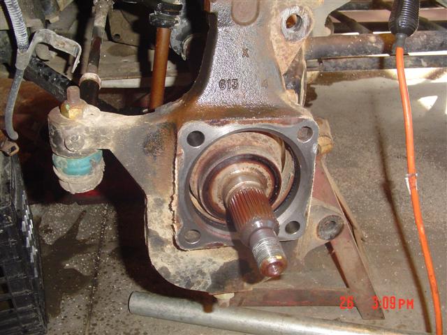

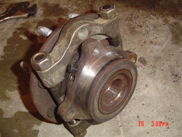

Heres a pic of the wheel bearing in the hub assy. , i have a bearing separator on it to put it in the press and take the bearing out. But i dont want to go through that if it comes from hummer and is cheap. does anyone know the price of the assy? thanks

nuther pic
