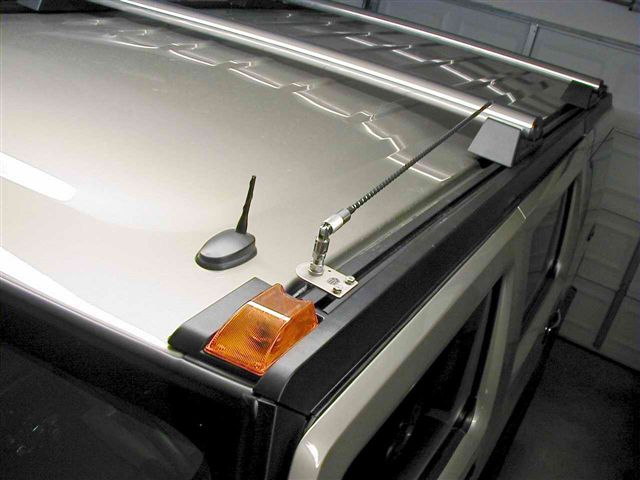

I figured out how to mount a CB antenna without drilling any holes.

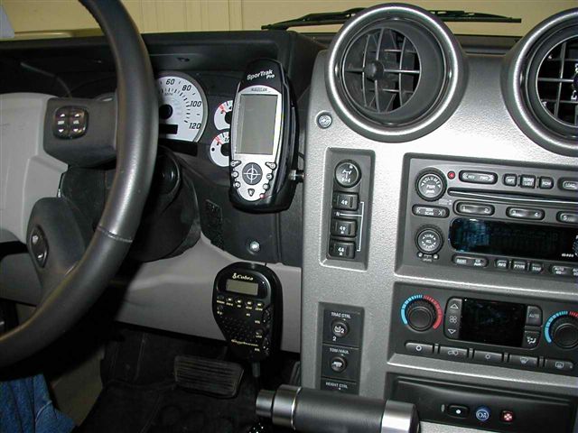

I mounted the antenna to the roof rack track. Using a firestik Jeep wrangler mount with a couple of washers added to the underside mounting plate. Then a fold down antenna mount with a firestik k40 added. I ran the coax into the marker light wiring hole. The whole thing is lower than my roof rack cross bars, so I dont have to ever remove it. When I transmit, I get good range with the antenna down and great range with it up.
