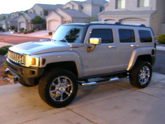

Where are you located? Is there a Discount tire near you? If you want to buy from a place you can go back to for service, I suggest finding a local wheel and tire shop that will rotate them and try to get some sort of warranty...
If you want a better price (like me) I just searched online for the wheel I thought I liked the most.
The wheel you need to be a factory look (without sticking out of the fenders) is a plus 30 MM offset, 6 x 5.5 bolt pattern (same pattern as most GM trucks), and a 100 or more center bore (larger than a normal GM).
This wheel is almost impossible to find (at least now) the bolt pattern is like a GM SUV, the offset is like an auto, and the center bore is big like Toyota.
This pic below has a plus 12 MM offset (looks mean, and offroad) and the tire is a Nitto 305/55/20 which means a 33" tall and 12.5 wide. That is the tallest tire you can get without a lift (per the wheel guy I used).
Couple wheels I know they make is a KMC Dime (because I ordered a set) the MKW Mk 26 (on the gray H3 below) there website is http://www.mkwheel.com
If you want a great website to look at all the styles available I like http://www.superbuytires.com, only problem is they do not have the offset, and bot pattern, and they are pretty much jerks on the phone. They say they have not TEST FIT the car yet, so nothing will fit... RIIIIIGHT.
