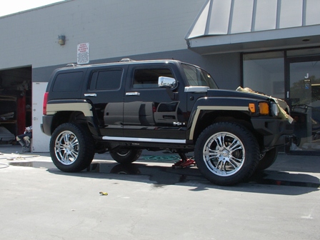

Location: Bradenton, Fl
Posts: 12
Not sure where this pic came from but does anyone know if this H3 has a lift? Also, any idea if the tires rub under normal driving?
08-09-2005, 11:22 AM
Location: JAPAN
Posts: 142
The bigger tires make it lifted, there is no lift kit installed on this H3. According to the shop, there is no rubbing problem.
