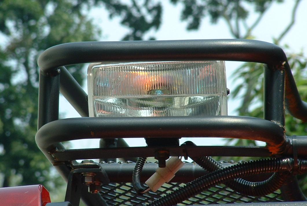

But this is totally different! I know that no matter what lights probably won't get sealed as tightly as we'd like and will still have condensation in them, but this is just rediculous. This is the left Piaa 560 on the back of my rack. It's filled halfway up! I just noticed this too while I was helping the g/f in the garden (it's 2PM here and it's been hot and sunny all day, wonder how long it'd take for it to evaporate?) Anyone have this happen? Any one have suggestions on how to better seal my lights? The right 560 just has a condensation coated lens, and my 520's up front get a little condensation in them from time to time, but nothing like this. LoL I left Gobi a message, just to see if they've run into this and if they've got any ideas.

Nope, haven't washed it in over a month. I was fiddling around with the light, just moving it, and it seems that just by pressing on the top of the lens water began to drop quite fast out of the bottom but only a little drained. I'll take it apart tomorrow and try switching the lens around. Thanks again

They are upsidedown. Same mistake I made with my PIAAs(she was thirsty).

Well Sandra at Gobi gave me a call back, she is going to call Piaa, I'll probably just have to send mine back and get a new set. I believe the lights are actually mounted upside down (dealer put them on) but I cannot remember why at the moment (I think it may be that they wouldn't mount the other way, I'll check it out) And I know most lights have some kind of a vent hole, but these have been on for months now, and this is the first time it's happened, on top of the fact that it hasn't even rained hard here lately! Those bulbs aren't blue per-say, thats just how they look from the factory, might be from the water and sunlight and reflections and such.Anyways, I think I'm gonna go take a look at them. I'll post if I find anything. Thanks Phil

(1) There should be no water in them. PIAA will do a warranty exchange no problem as long as the lense is not cracked.
(2) You should not need to switch the lense around. The bracket can mount from the top or the bottom.

I installed mine myself and actually read the manual. You should be able to read PIAA if you cannot take the lens assembly out and turn it 180 degrees and reinstall. They have small vent holes that allow condensation to escape during temperature variations.
http://www.piaa.com/warranty.html#trouble
Go down too the bulbs section. Sorry Grim
