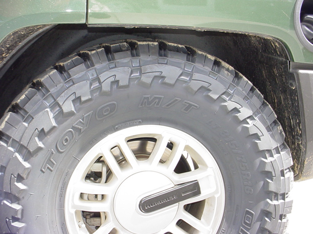

the one concern is this small plastic flange i think i will cut it back with a razor knife

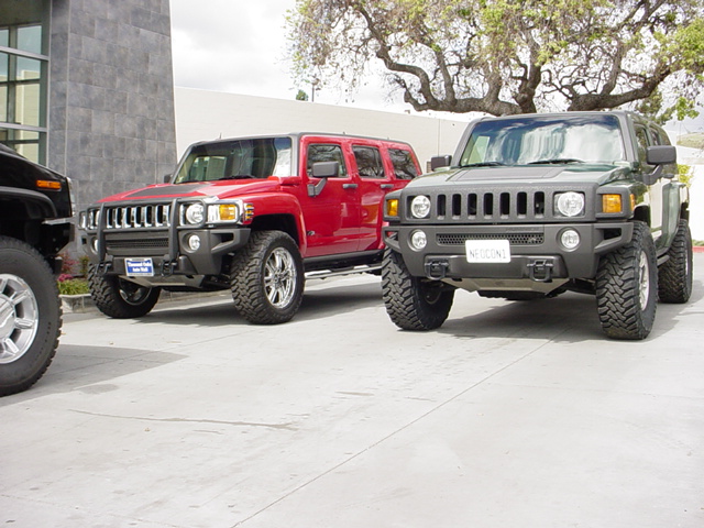

here you see 33's on a 20 inch rim compare to my 35's on the stock 16's

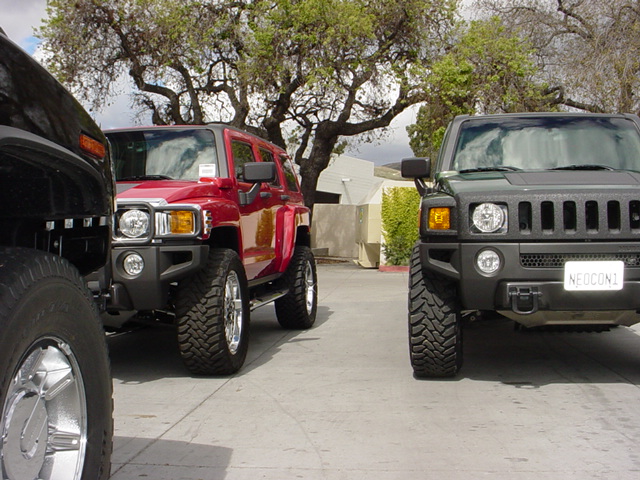

compare tires here

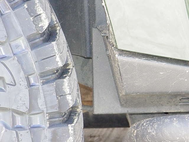

Old 03-13-2006, 04:18 AM

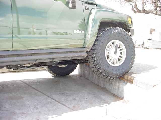

this plastic flange is the only thing thats close to rubbing

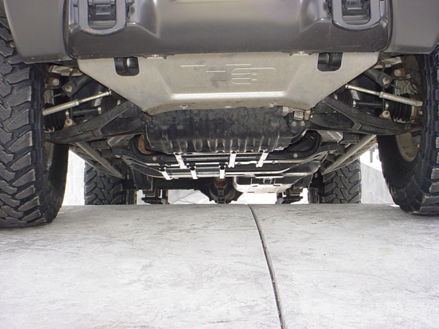

Old 03-13-2006, 04:19 AM

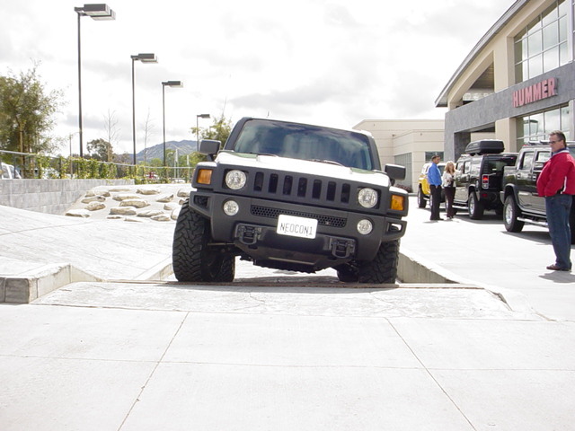

Posts: 1,174
Those Toyo MTs look great on your machine. I really like the look, that might be my next set only slightly smaller. I think being quiet is a HUGE bonus for that aggressive of a tread. Your wheelwell clearance doesn't look that bad, just makes sure you twist the suspension to its limit (toughest test for rear end), cut the wheels hard all the way in a steep descending position(always toughest on the front end), and climb it to make sure nothing rubs. I've always been partial to the Toyo MTs and Goodyear MTRs. I can tell you from my experience with them on two vehicles the Goodyear MTRs perform well with bullet proof sidewalls, but are loud, even when they are aired up to street pressures, so the Toyos will probably be my next tires after these ATSs.

NEO- MORE GREAT PICS!
now, on that little plastic thing you want to cut with a razor knife.....
I hit on mine. That's the only thing I hit with the 35's. There is metal behind that plastic. So, I'm not sure what it's for, but it may be part of a support for something???

Old 03-14-2006, 01:55 AM
hey tim thanks man , how bad are yours rubbing on that little piece ? i have only gotten very close to touching it so far . i noticed the second piece today while under there . they have a fastner away from the flange and i could add an extra screw or bolt after i cut it . the platic raps around but you can make it flap with your hand so not to secure . i think the plasic piece keeps mud from going between the lower plastic rocker piece and the metal piece behind it , i thought it was thicker plastic behind there i have only reached in not gotten up in there yet but seemed flexable . i will keep updating when i trim it . i need to research that better , i can try to get an exploded view of rocker assembly and see how those pieces go together . stay tuned we may end up trimmin these in the parking lot of the GONZO LOL
