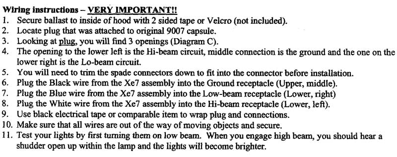

Old 10-15-2007, 06:37 AM
Default Re: HID Headlight help
Sorry this took so long. I had to dig around to find these instructions.
