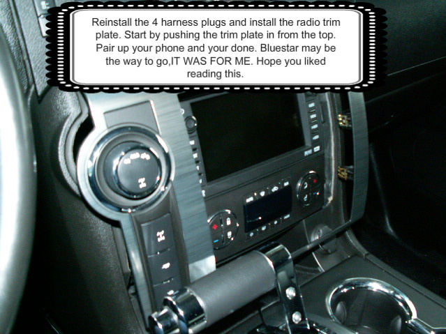

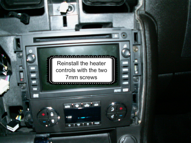

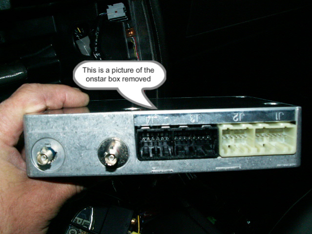

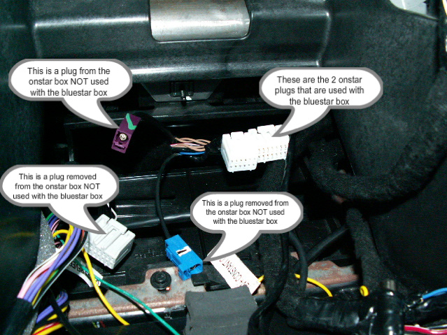

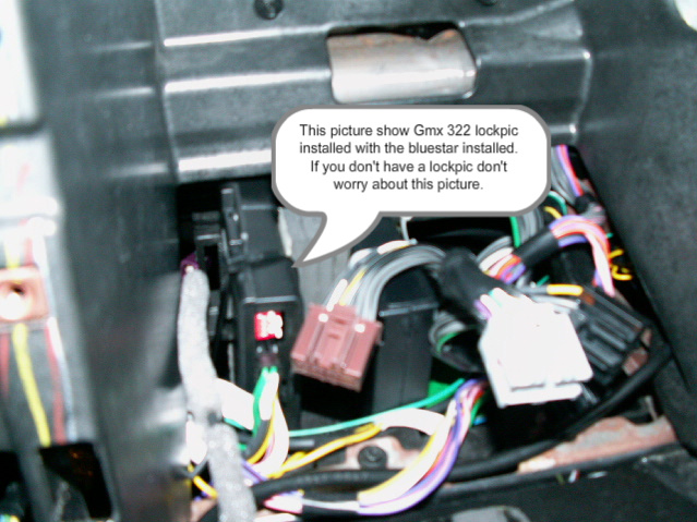

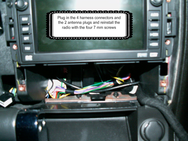

Default 2008 hummer h2 Bluestar Install

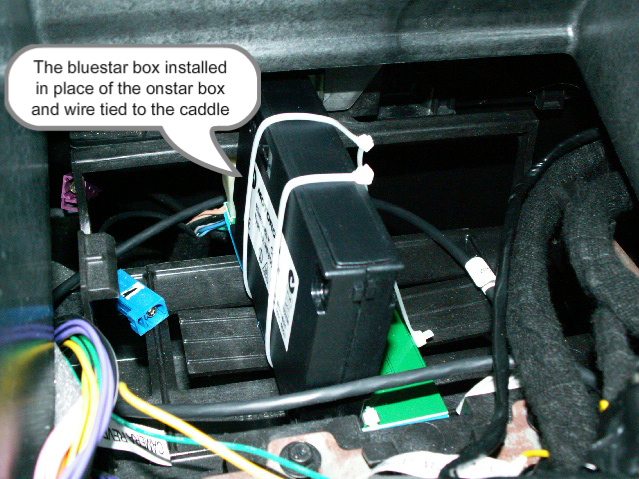

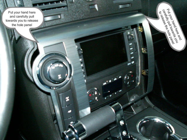

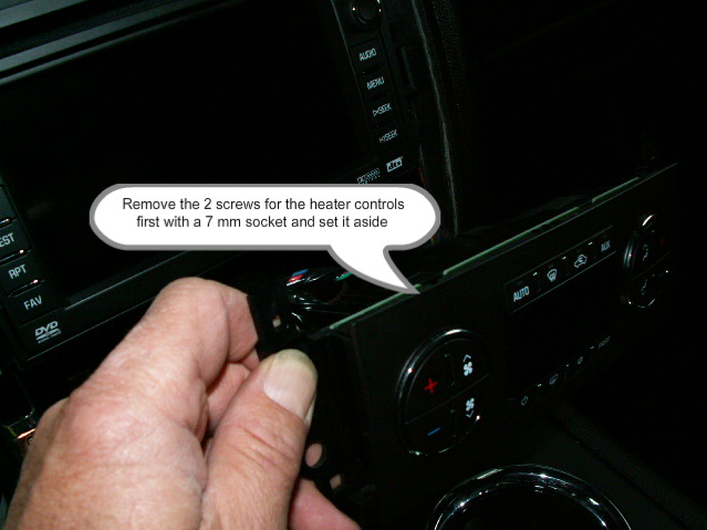

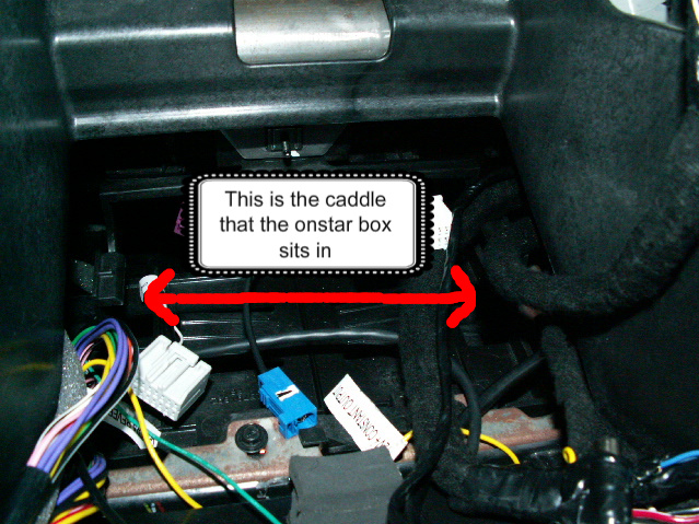

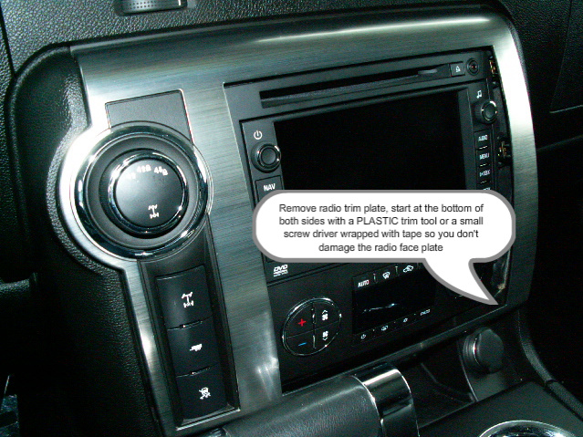

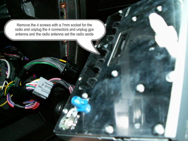

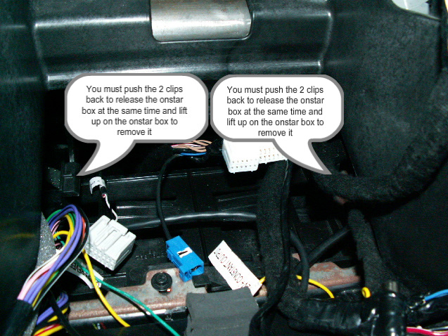

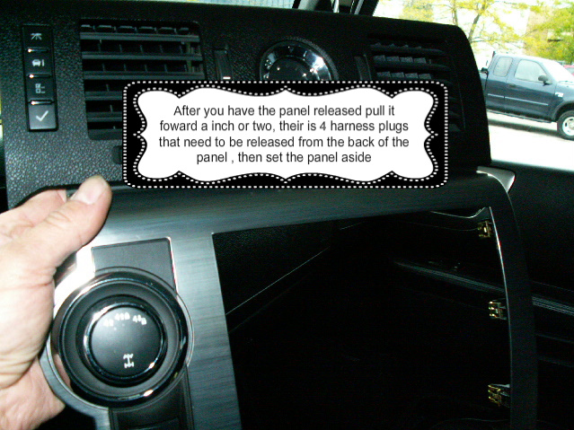

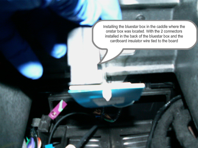

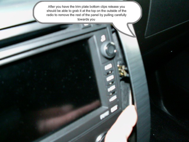

Install a Bluestar unit in your 2008 h2 with or without a lockpic GMX 322.
I should add non navigation radio's install is basically the same.
When a call comes in or you calling out. It will mute the radio and turn down heater fan speed, then all will resume after the call has ended.
This is the kit # for a 2008 h2
**BlueSTAR PnP GMLAN-29 Complete Kit ..........$279 **
Someone will ask about older hummer models. The install for these models will be different than the pictures below.
Kit # for H2, 2003/ 2007 or H3, 2006/2007
**BlueSTAR PnP Class2 Complete Kit ......... $249**
STEP 1
