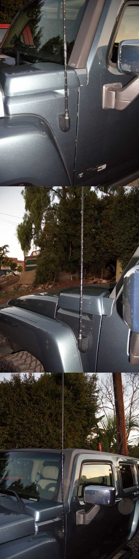

Got the antenna mounted. It now offsets the factory radio antenna by being mounted on the opposite side in the same location on the fender. Ran the antenna wire from behind glove box, out a grommet hole in the frame above the front door hinge (silicon sealed the grommet when done) up and over the top behind the cowling trim and into the other side fender. This way it was invisible and does not interfere with anything.

<BLOCKQUOTE class="ip-ubbcode-quote"><div class="ip-ubbcode-quote-title">quote:</div><div class="ip-ubbcode-quote-content">Originally posted by The Green Lantern:
- do you have a pic from the side?
thanks </div></BLOCKQUOTE>
Hope these shots help, couldn't get a good angle.
one cool thing, is that you do not see it when driving, the A pillar hides it very nicely.
