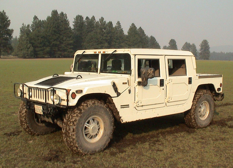

If you want my opinion, since you DO actually go wheeling on more than dirt trails, you would benefit from the suspension lift only if you wanted to go to 39.5 or larger tires. Otherwise it would look goofy with the 37's.
The 40 MT/R would be perfect for you, since you drive yours both on and off highway. Best part is you don't need to do a body lift since the Alpha is already lifted (and with the 12" brakes I might add).
