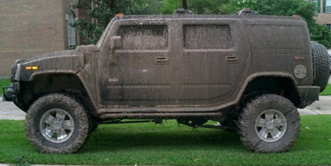

I have the Rancho lift and i have 39.5" tires, doesnt rub under normal driving conditions only when i am offroading and i take a bump too fast while turning here is a picture

that look nice that is the look i want no i just need a 22x12" rim and there is not one avalable so i might mill down a set of 22.5" floater rims(alcoa's)

is that a 20 or an 18 inch rim..?

The wheels on my H2 are 20" Wheels
