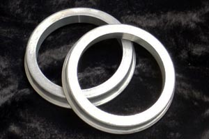

I'm still too lazy, but the measurement I was looking for is the hub bore ID.
On the Colorado, Canyon and H3 it is 3.94".
So all GM bolt patterns while correct have too large a hub bore of 4.595". I don't know if this is an issue?
I guess not, bigger is better than smaller.

FormerJeeper, the hub bore should be the same size. If it's bigger, the center of the wheel is not positioned properly, as a result, at high speed driving, the wheels shake, and in the worst case, the bolts are broken. If you want to use the wheel which has bigger hub bore, you had better use hub centric rings.

Actually the H3/Canyon/Colorado is smaller than the normal GM trucks which is 4.595" - this is why it wont work.
Thanks BB this is what I thought
